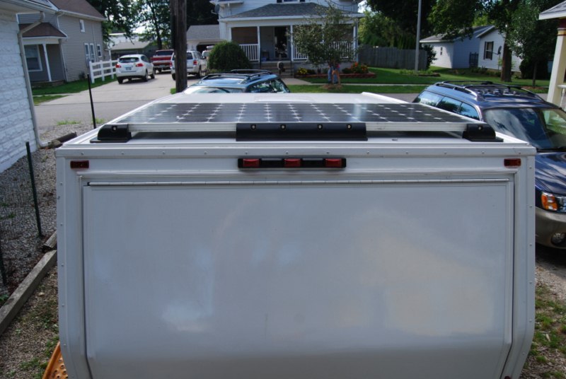

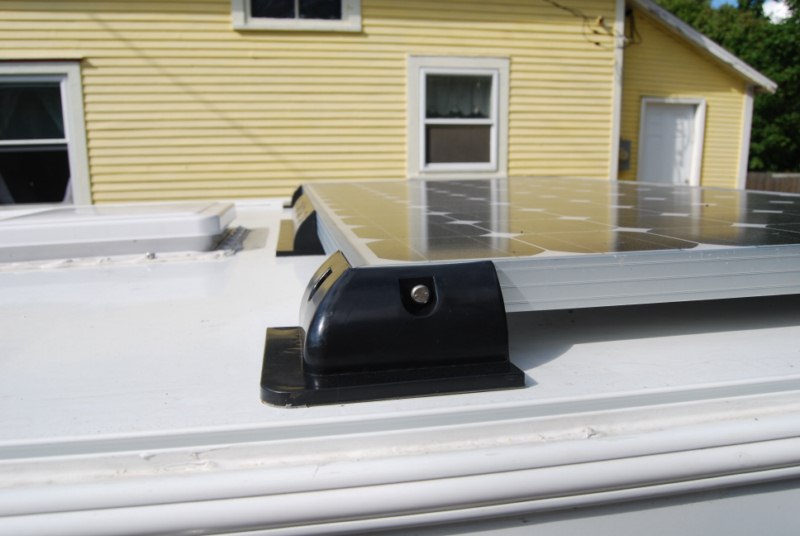

Postby Shadow Catcher » Tue Jan 31, 2012 7:11 pm
I have two solar panels one mounted to the roof and the other is a flexible panel that can be set out in the sun when needed. One of my big concerns is that I did not want holes in the Filon roof. I also wanted a mount that would make stealing the panel as time consuming and difficult as possible. I found ABS plastic mounts with recessed holes to bolt to the panel and found theft resistant screws not in the Harbor Freight 100 piece set. The seller of the mounts available in Europe were not willing to export them to the US. So I tracked down the manufacturer in China who was.
The mounts are attached with 3M VHB tape (no holes in the roof) after consulting with a 3M engineer.
