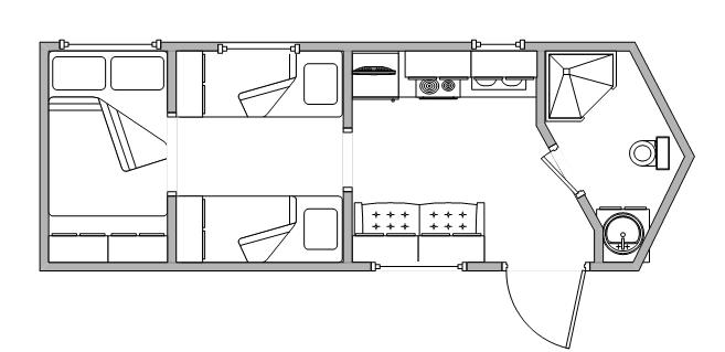

Hi all, My wife and I decided that we did not want to pay the outrageous price for a travel trailer that would still not meet our needs. We currently have an older 20' TT (Damon Hornet) that has the back rotted out of it, and would need some serious remodeling to meet our needs. So after some serious thought and hand wringing, we have decided to take the plunge into the world of cargo conversion. So far, we have ordered an 8.5 x 22 v nose and started the planning process. The old Damon Hornet will donate the roof AC, propane stove, stainless steel sink, Propane furnace, inverter, and maybe the windows. I hope to get feedback from everyone on my layout, as one of my biggest concerns is weight distribution. I have already gleaned a great deal of information from reading about all of the builds everyone has done. Thanks in advance for your input.

Does anyone see anything about my layout that would possibly cause weight distribution concerns? I will also probably be asking about wiring when we get to that point in the build. I can read the books to find out, but book knowledge only goes so far.

You may have an issue running the toilet there, if there is a 3x3 running through the middle you'll be pooched, but overall the plan looks great
The kitchen just ahead of center axel is best for weight distribution

Postby b.bodemer » Sun Mar 04, 2012 12:11 pm
Nice layout planned!

Thanks Chris. I do have some ability to move things around in the bathroom to accommodate for just those types of potential issues. I won't know for sure until i am able to get into the build. We hope to get the trailer sometime mid-month. For now we will be planning, and pulling parts out of the old TT.
