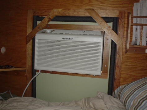

Postby Mary K » Tue Mar 06, 2012 3:54 pm
Here is a Pic from b.bodemer TD.
Looks like the door stays on and she made a "plug" with the AC attached. Sweet.

Postby b.bodemer » Tue Mar 06, 2012 6:44 pm
On my cargo trailer I did this:
http://cttraveltrailer.blogspot.com/201 ... alled.html
In cooler weather I can put the a/c in the garage. That gains me more counter space. I use a nylon bolt through the slider and into the countertop to keep it in place while traveling. I use two straps to then wrap around it to the slider.
Set up stayed in place while traveling and worked great in camp.

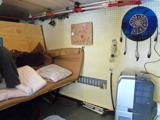

Postby Wolfscout » Wed Mar 07, 2012 4:33 pm
I used two small eyebolts and ran a bungie cord. It's all I needed to keep mine portable 12,000 from rolling around on the floor.
It's been enough AC for me. People get all excited about their favorite product, but often times others have differing opinions and success.
Give it a try and luck to you. I've enjoyed mine.
In this pic. you can see the eyebolt and my bungie cord. Image
