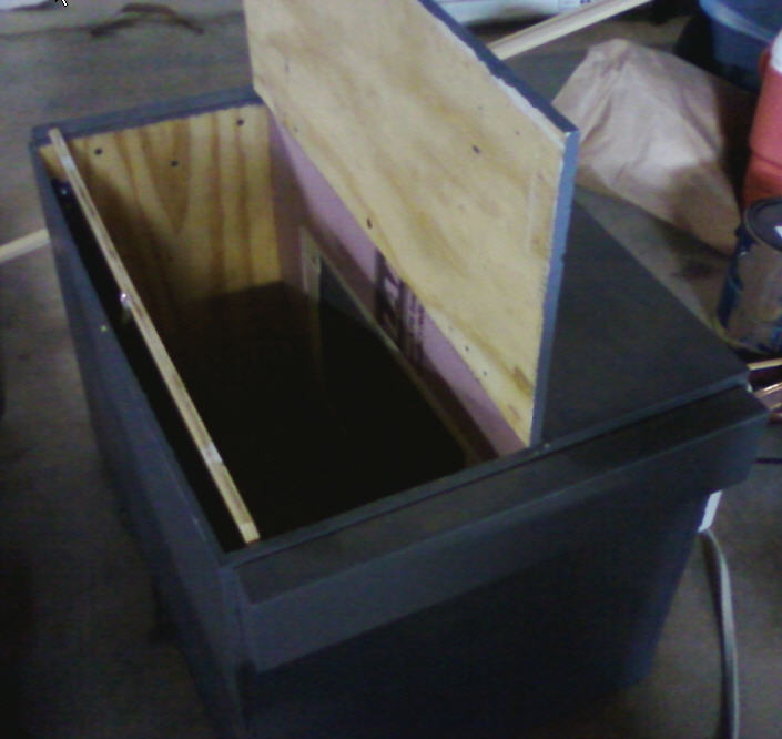

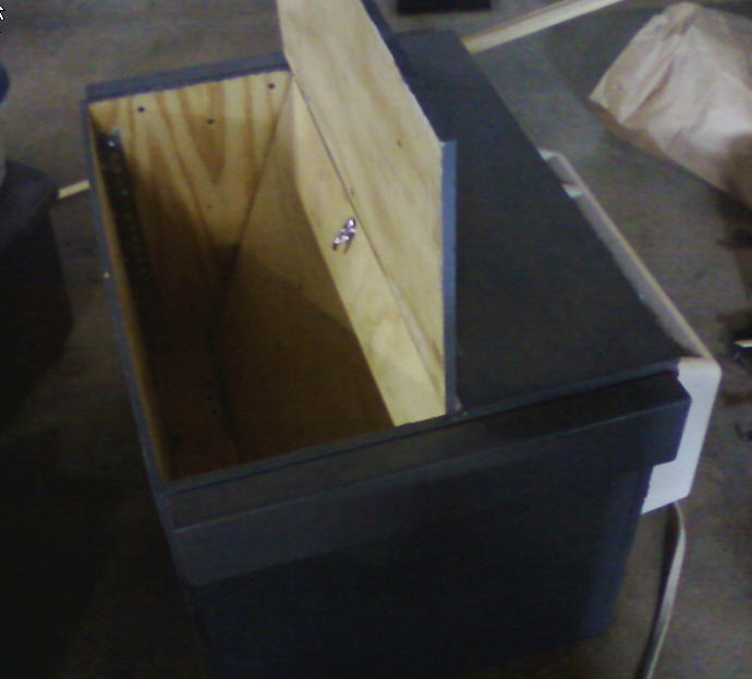

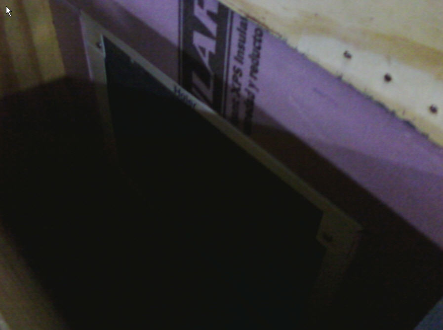

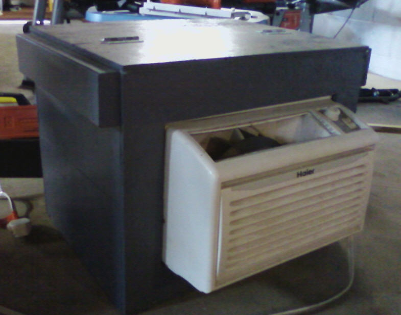

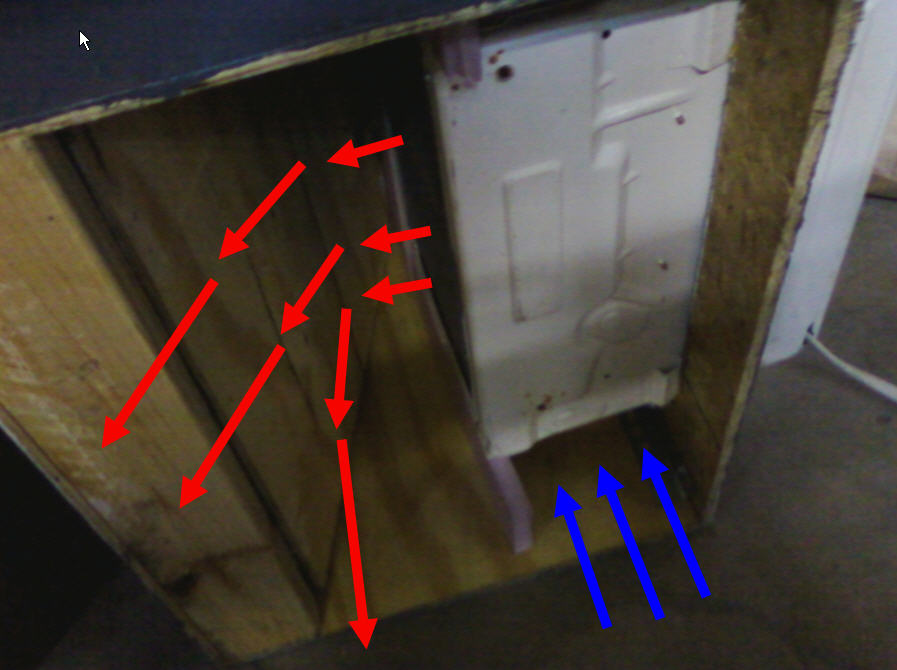

I made a box for the unit to sit in that sits over a hole in the floor. Inside the box I have a board running at an angle to deflect the heat down and out the bottom side of the trailer. I also made a cutout that fits over the back of the unit to seperate the hot exhausted air from the intake air. Works good.

The condensation and heat from the unit both exahust through the hole I cut in the floor. The hole is just slightly smaller that the outside perimeter of the box. I couldn't bring myself to cut a hole in the side of my trailer, it's easier to replace the floor.
Another reason I like this setup is it provides an escape route if you've read other threads on here about people's concerns with being locked inside their trailer.
