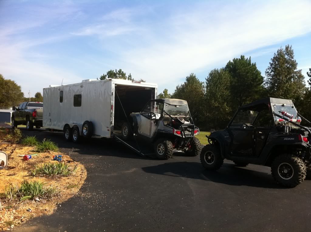

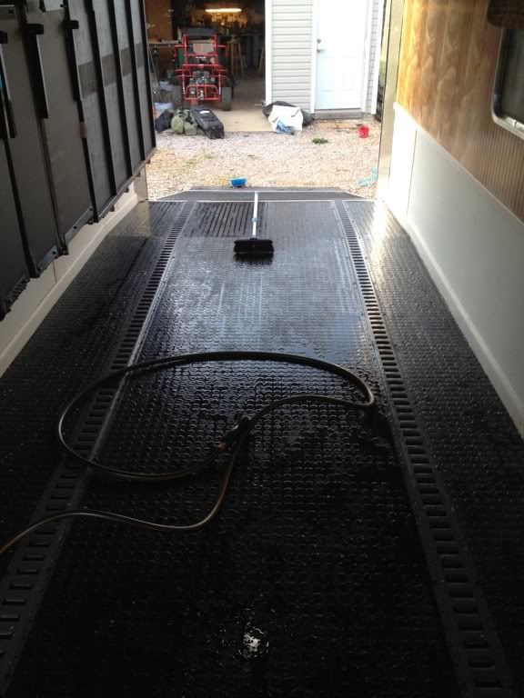

Postby 8ball_99 » Tue Jun 05, 2012 8:41 am
I vote rubber floor. They sell it in the raised coin pattern or diamond tread. Its tough, waterproof and much cheaper the spray in bedliner Like line-X or rhino.
Mine is holding up great and I park two of these in my trailer
And for the guys asking why do you need your floor waterproof.. One because you will have to park wet machines on it at some point and two when its time to clean the mud out its much easier if you can do this.
