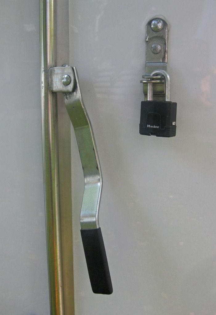

catlin987987 wrote:I am looking into converting a cargo into a travel trailer, but I was wondering how do you open the man door from the inside? Most man doors I have seen have the bar that goes across the door, some one could lock you in.

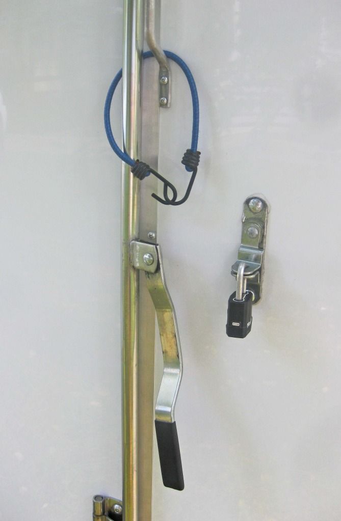

You will need to install an RV latch or have one installed. Then you can either remove the cam bar lock or more likely install an additional hasp to lock it in the open position. The RV latch will allow you to open the side door from the inside and by locking the cam bar lock in the open position no one would be able to lock you in. :twisted:

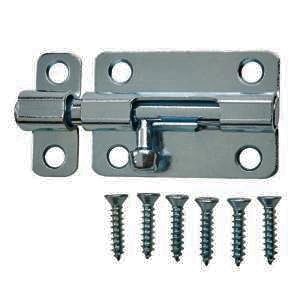

Certainly the RV Latch that bigbendhiker mentioned would be the most elegant. Perhaps the simplest would be to add an inside door latch,
and locking the outside latch closed when camping in it. Of course, if someone is hell-bent on locking you in, they could wrap a lock or wire
around the door handle and cam bar... and of course, they could do that even if you installed an additional hasp to lock the cam bar in the open position...
