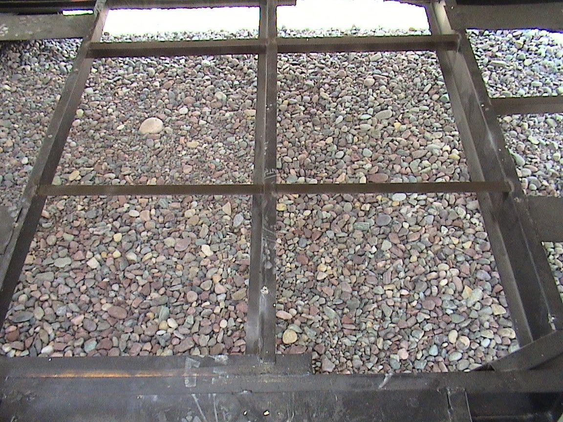

1.Floor feels spongy under my 300 lbs (so how will it react to 800 lb quad?)
I pulled floor board and see a large gap with no support.
Love to do something myself without paying a welder.
I'd just screw in some 2x6's sideways if both beams had the lip, but every other beam has lip at top.
Any recommendations?

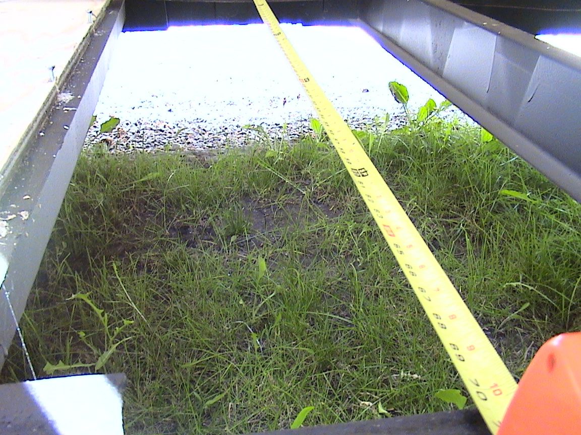

The large gaps are 68" wide and the between beams is 48" wide with hole being 23 3/4".
So no wonder the whole floor is flexing:
Those wide strips are skinny metal just for screwing in cargo straps - not weight-bearing. So the untreated plywood is the only thing between cargo and the road :shock:
All front beams are rusted
and a couple side beams.
Duct tape peeled paint right off a top beam:
Oh well, I guess that's the difference between my $5,000 trailer and a $10,000 one ;)

8ball_99 wrote:Oh I see what your saying. Your joists are at 24 center but the metal straps across the top have a gap. Honestly that doesn't matter most trailers mine included don't have those metal strips. I thought you were saying your joists them selves were 48" apart
My bad - it is 24" to center but that gap is 68" wide, so I'm heading to welder Monday to price options.

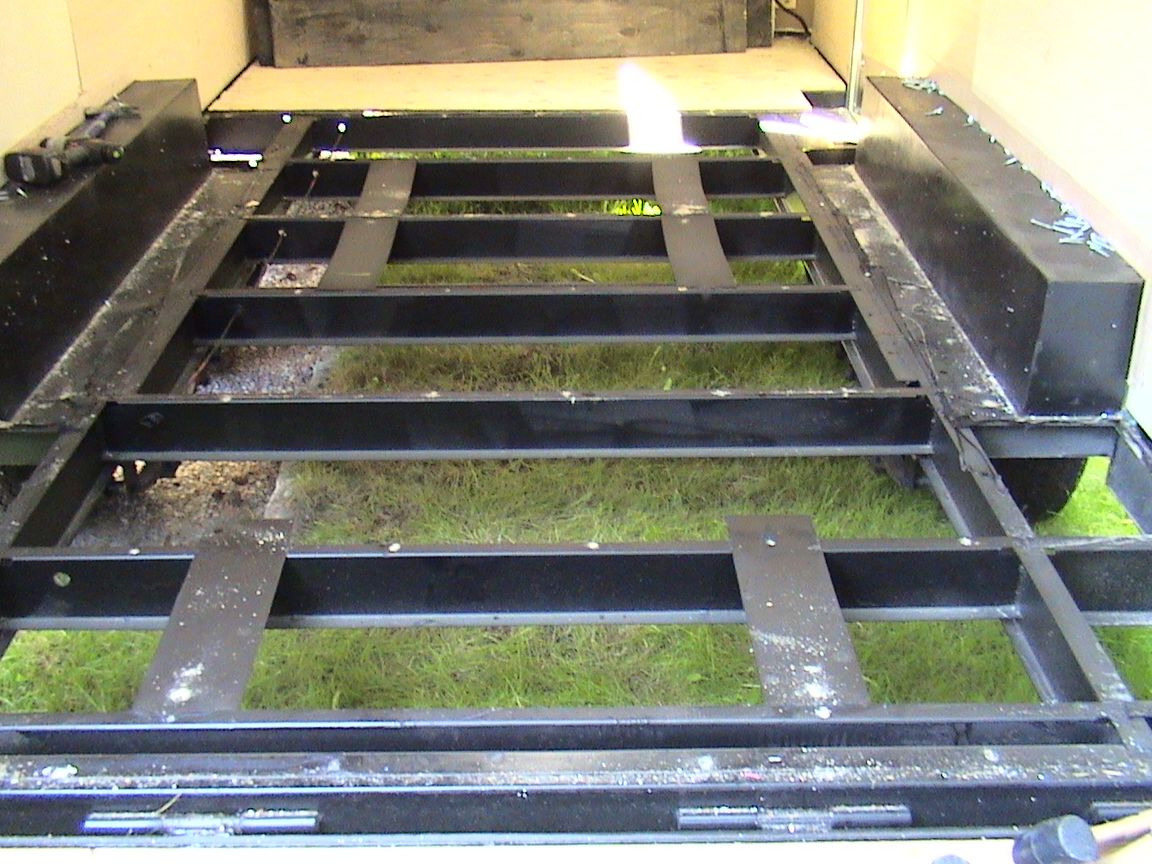

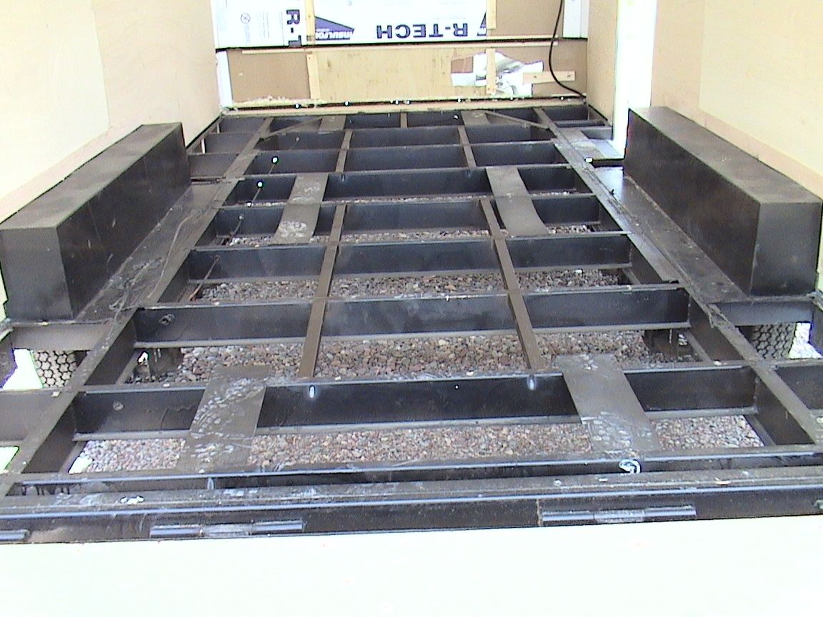

Postby notoriouskelly » Mon Jul 16, 2012 5:40 pm
Welder hooked me up for $295 (plus tip) :D
Helped me get boards in and out of trailer, welded braces, 10 cans of undercoat rubberized spray to beef up underside and bracing against elements.
Before and after pics:
Big Gaps
Braced floor
(There's bracing under the wide strips)
Gaping 68" rectangular hole
Squared strength
Cursory spray
More thorough coating after
Now I can get on with the project! 8)

Postby Glenlivet » Mon Jul 16, 2012 6:02 pm
That looks a lot stronger notoriouskelly. :thumbsup:
Glenlivet
Posts: 145
Joined: Thu Sep 08, 2011 10:07 pm
Location: Hope B.C.
Re: How to strengthen frame, insulate under trailer
Postby surfdog » Tue Jul 17, 2012 6:41 am
Well Done! MUCH stronger for the Quad. :thumbsup:
