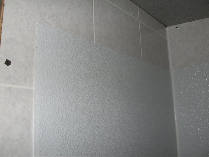

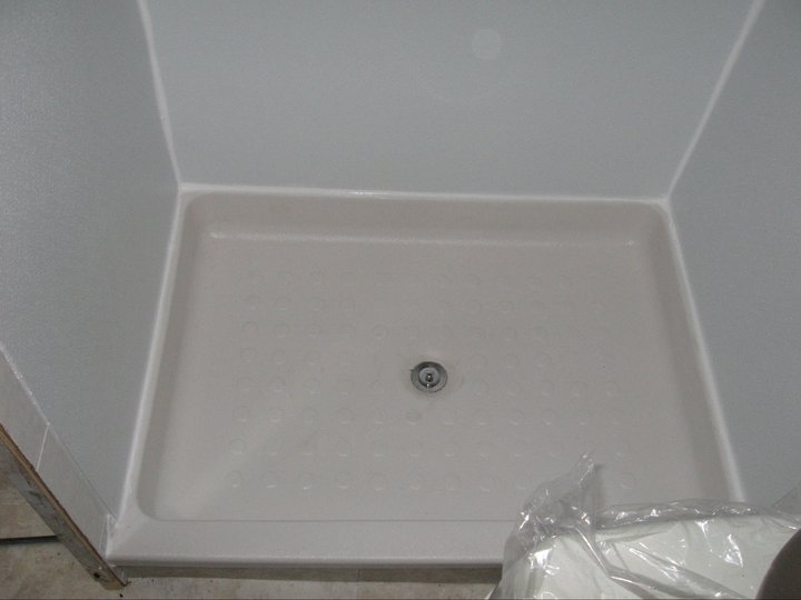

This is how I built my shower using an RV shower pan and the white panels from Lowes. I glued mine to some fake tile board that was used for the remainder of the bathroom. Instead of using liquid nails however I used Loctite Power Grab since it is white, cleans up easily, is thinner, and grabs the panels instantly unlike Liquid Nails. Oh yeah firsr post and all LOL. My build will be put on here soon.
