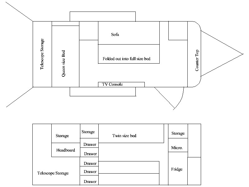

Here is a starting point on the layout
This is a starting point. Any suggestions or ideas will be greatly appreciated.

Re: Project: Stargazer
Postby DTCOOPER » Thu Nov 08, 2012 1:26 pm
The beauty of a CT conversion is that our imaginations are the only limits.. We've had ours about 3-4 months, and our layout has changed a few times. We use ours for toy hauling and camping. You can check out some of the pictures in my build thread to see what we've done thus far. One thing I can't stress enough is "INSULATE, INSULATE, INSULATE"...
It makes for much more comfort at all times. And also using the AC or Heater less time.
Good luck with your build, and post lots of pictures. Please don't hesitate to ask any questions you may have.

Postby E. Aaron Scott » Thu Nov 08, 2012 4:17 pm
Hey thanks. Insulation will be key. I live in Oklahoma and for three to four months of the year we have to run A/C during the day and blast the heater at night.
Right now before we get too much into plans I need to establish the towing capacity of my truck. I'm pretty positive that I have the power but I don't want to over do it. Also would a 7X18 be too much for a 1/2 ton? I pulled one of those 6X12 U-Haul trailers loaded while moving and could barely tell that it was back there. Since then I got the new engine and add close to another 100 hp.
If someone could point me in the direction of a reliable place to find out what my towing capacity is, that would be great.
-Aaron KF5VBV
Postby DTCOOPER » Thu Nov 08, 2012 4:37 pm
unfortunately, the engine and transmission aren't going to do much for your tow "rating". However, we both know that those items will increase the pleasure of towing said load.
1/2 ton trucks weren't rated to tow nearly as much 15-20 years ago, as they have been in the past say 5-8 years.
My 1/2 ton Tundra is rated to tow 10k. I wouldn't make a habit of it though. I towed a 8k pound camper about 800 miles in August. And while the truck did fine, and the added trailer brakes helped, it was not an "enjoyable" experience for me. Your trailer should weigh roughly 2800-3000 dry I'd think. Your truck is probably rated to tow 5k. And I believe you'd be safe and reasonable to tow every bit of that 5k. Especially if you'd add some helper leaf springs or air bags in the rear. I'd seriously suggest trailer brakes. They make towing much more enjoyable, knowing you can stop safely and effectively.
my 24' CT weighed 3200 empty. Now with insulation, paneling, wiring, e trac, holding tanks, dorm frig, etc. I'm at 3800 pounds.
I figure by the time I install the cabinets, shower pan, bathroom walls, etc. I'll be around 4500 pounds. And that's before I add the toys in the back (Harley, 4 wheelers, dirtbikes, Kawasaki Mule). :thinking:

Postby E. Aaron Scott » Thu Nov 08, 2012 5:22 pm
The size of the trailer is not set in stone. The 7X18 would be the maximum size that I would want to pull. About 99% of the time I will be using it by myself and my family will be in it an average of 20 nights a year spread out over the year. If I can find or think of a smaller design for 4 people to sleep comfortable (me and the wife in one bed and I have two kids and they would each need a bed) then I would prefer that. I looked at Slide In Campers and they were just too cramped, weighed too much for my truck and cost way too much. I just want something that we can sleep in, and still move around during the night and something as open as possible during the day. I could go with even a 6X12 if I could figure out a way to make it work.
As far as breaks, to me personally I won't pull a trailer that does not have them. I always make it a habit to be more caution then necessary. So trailer breaks are a must.
I'm also wondering if anyone has ever done a slide out section on a cargo trailer. Not sure if the frame could handle something like that though.
-Aaron KF5VBV

Postby E. Aaron Scott » Fri Nov 09, 2012 12:08 pm
Well I finally got one problem solved. I went to http://www.chevrolet.com and emailed them with my VIN and GVRW and everything else I could think of. I didn't expect anything because I have done this in the past with no luck. Within an hour I got this response.
Dear Aaron,
Thank you for contacting the Chevrolet Customer Assistance Center. We appreciate you taking the time to write us about your interest in finding out the towing capacity, the GCWR of your 1993 Chevrolet C1500.
We are more than glad to assist you on this matter. We have carefully researched the information you are seeking and based from the info that we got, the towing capacity of your vehicle is 6500 lbs and the GCWR (Gross Combination Weight Rating) of your vehicle is 11,000 lbs. In addition, Maximum trailer ratings are calculated assuming standard equipped vehicle, driver and required trailering equipments. The weight of optional equipment, passengers and cargo will reduce the maximum trailer weight your vehicle can tow. 10 to 15% of the trailer weight is the recommended trailer tongue load. A good rule of thumb is to distribute 60% of the load of the trailer and evenly from side to side. We hope that this information has been helpful to you.
If you should need to contact us in the future, simply reply to this message or call our Chevrolet Customer Assistance Center at 1-800-222-1020. Customer Relationship Specialists are available Monday through Saturday from 8:00 a.m. to 9:00 p.m., Eastern Time.
I was a bit surprised with the 6500# tow weight. It is much better then the 4k or 5k that I was expecting. So now I'm pretty positive that my plans should be ok with weight. I do not think I will go 5k in my conversion at the most, but I needed to make sure.
-Aaron KF5VBV
