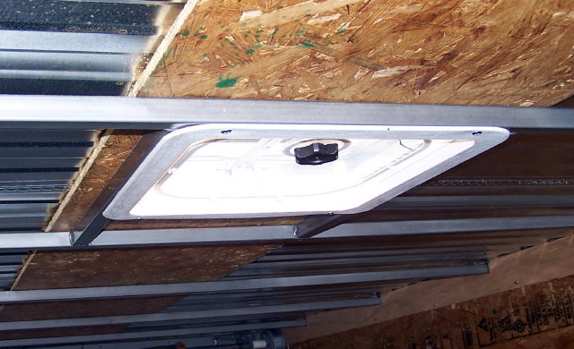

How much (more) bracing is required for a roof mount A/C? Is the bracing in the attached picture adequate? The picture is of the inside of the roof of one of my trailers.

I have seen some factory travel trailers that have a window AC mounted in the front side cabinets with a small amount sticking thru the wall.
I really like how b.bodemer did her's it is mounted on a sliding tray that is carried inside when she gets to a campground she opens a
cargo door which is mounted to open up she then slids the AC out the opening very well thought out.
On the travel trailers I have owned I've always had a roof AC some with a heat strip which is a 1500 watt heater.
I guess I wasn't much help but at least you have a couple of ideas.
