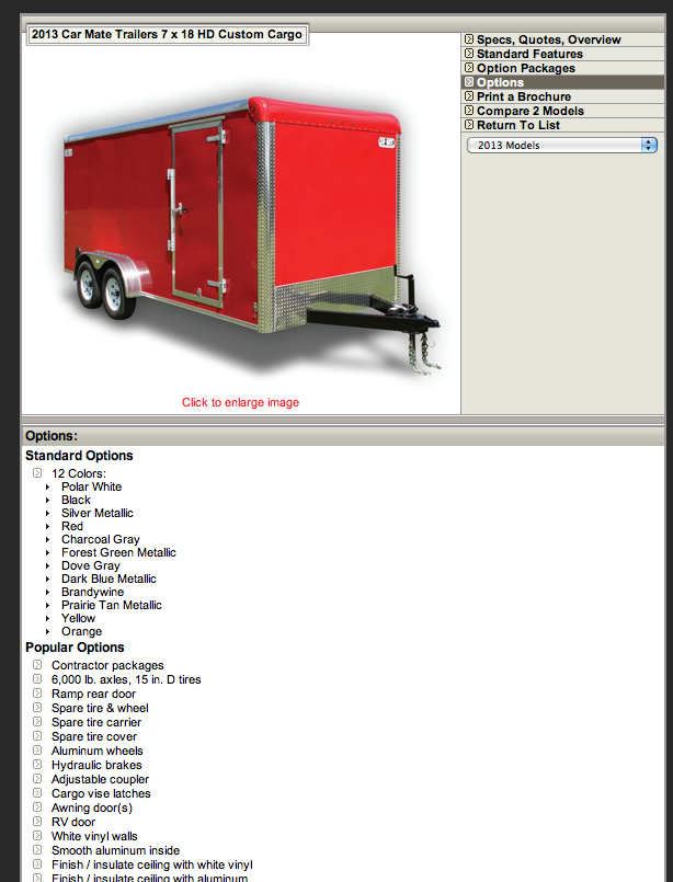

Most places don't list any prices, I would guess $6500+ for this model maybe, depending on options ?
A 7 ft wide Car Carrier like model, others don't make that. If you like that style you need to got 8.5 wide & starts at 20' normally.
their models start at 7 x 12 already :D :D
a 7 ft car hauler type.png (182.5 KiB) Viewed 5022 times
http://www.carmate-trailers.com/new_vehicle_list.asp?sid=08183252X12K27K2012J5I51I09JPMQ5267R0&Manufacturer=2359&Category=85&CatDesc=Cargo+Trailers&ModelYear=2013&childof=317844&show=all

I checked with the factory about prices for these 4 models that I liked, so here it is !!
The guy Ted Harrison seams pretty nice to deal with.
Enclosed for your review is the MSRP & Empty weights you requested.
Price Empty Weight
2013 Car Mate Trailers 7 x 18 HD Custom Cargo $5,795.00 Approx 2370#
2013 Car Mate Trailers 7 x 16 HD Custom Cargo $5,595.00 Approx 2155#
I have noticed the 8 ft version
2013 Car Mate Trailers 8 x 18 HD Custom Cargo $6,695.00 Approx 2505#
2013 Car Mate Trailers 8 x 16 HD Custom Cargo $6,495.00 Approx 2375#

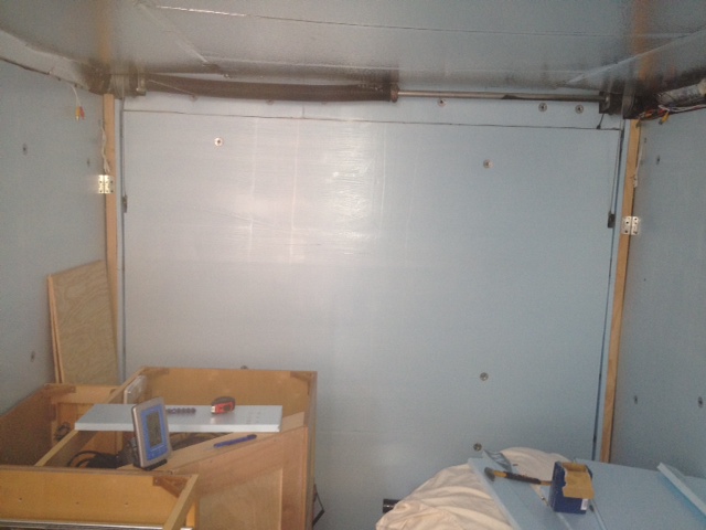

as long as I can take the plywood off & insulate Alaska style,
with killer insulation you can cool this to a ice box with less then 5,000 Btu in 100+ deg heat ac
also the same goes for the heating
:beer: :beer: :beer: more money for beer & bate for fishing

see my picture above, I will install 1.5"Dow foam board over the studs ,
Then install plywood or vinyl siding, in that case there is zero condensation , zero infiltration
The trailer will in effect be 98% air tight , 30- 40% of heat is lost by infiltration 50 - 60% by conduction
People forget if you have R6 between the studs, you do not have R6 , the studs them selves are R1 maybe !
So you really have R6 in 75% and R1 in 25% of your wall space. The heat is lost or gained through the studs.
Then even if you have R30 - you have massive infiltration
99% of trailer guys also don't do the floor BIG MISTAKE !! Heat takes the path of least resistance
100% do the insulation wrong, I'm former insulation contractor & fell into the trap
Because all these guys said their insulation works , I followed their advice and
Had rivers of consendation in the winter time , now I had to do it over - to get it right !!
Jerry
