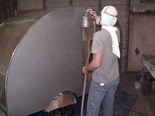

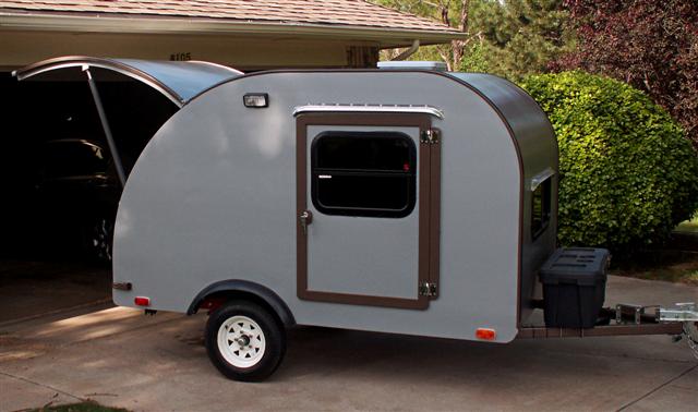

Hi, my trailer is done with Rustoleum (but its the "hammered finish" variety). My son sprayed it on using an HVLP sprayer and the manufacturer's recommended thinner (I don't remember what that product was, but we picked it up at a Shirwin-Williams place I think). He also sprayed my aluminum trim and door trim with a contrasting Rustoleum color. We did have the advantage of being able to apply it inside his shop. That was about 3 years ago & it still looks good. I don't think you'll be disappointed in the process if you want to avoid the high cost of automotive paint.
Good Luck,
Mike
Here you can see some of the texture of the "hammered finish":
Applying the finish:

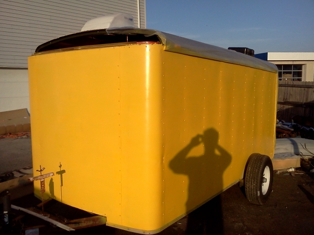

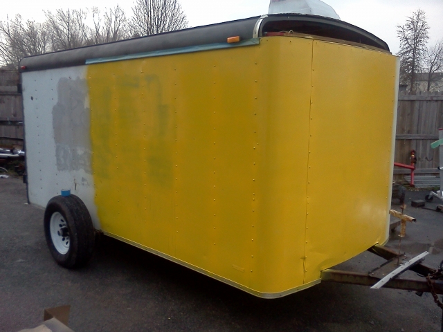

Postby A Plus MM » Sun Feb 03, 2013 12:24 am
Well, I'm about 3/4 done with painting. The front and both sides have been painted and the scoop (is that what you call the cap on the top-front of the box?) is painted but has not been re-installed yet. The back doors still need paint and the fenders need modified, painted and mounted and I should be done. In the first picture I had painted the front and part of one side with one coat - sprayed on with a Harbor Freight $15 sprayer, thinned about 3/2 with mineral spirits and no sanding between coats. It's not a high gloss paint like I'm sure it would be if I put some elbow grease into it but hey, it looks a LOT better than it did. So far I have used one quart of paint and one quart of mineral spirits for the yellow. I used a full rattle can of white on the scoop and I am going to use rattle can primer and spray bedliner on the fenders. I'll also buy another quart of the yellow for the doors and maybe another coat on the rest of the trailer. I didn't count the coats going on as it went on much faster than I expected and I was able to apply more coats quickly as it dried fast.
