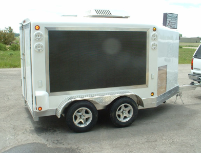

Hey is this the new 4k 80" tv From the 2013 Vegas electronic trade show ??
Damn I want this for my trailer 8) 8) 8)
a screen tv .png (173.19 KiB) Viewed 31965 times
