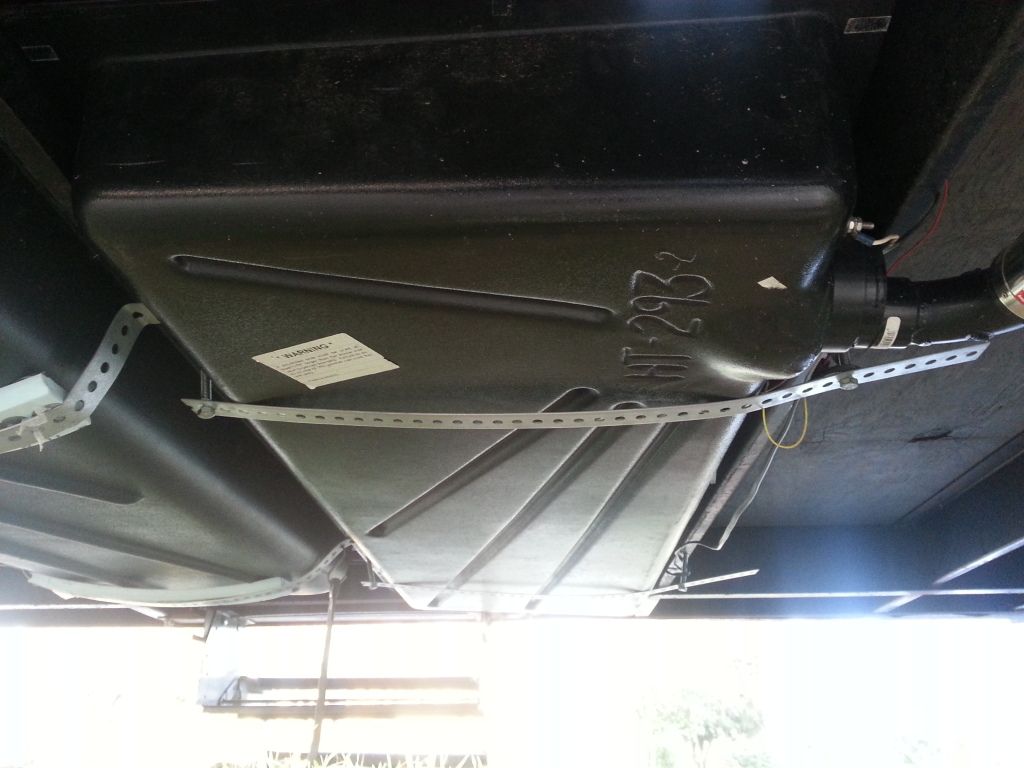

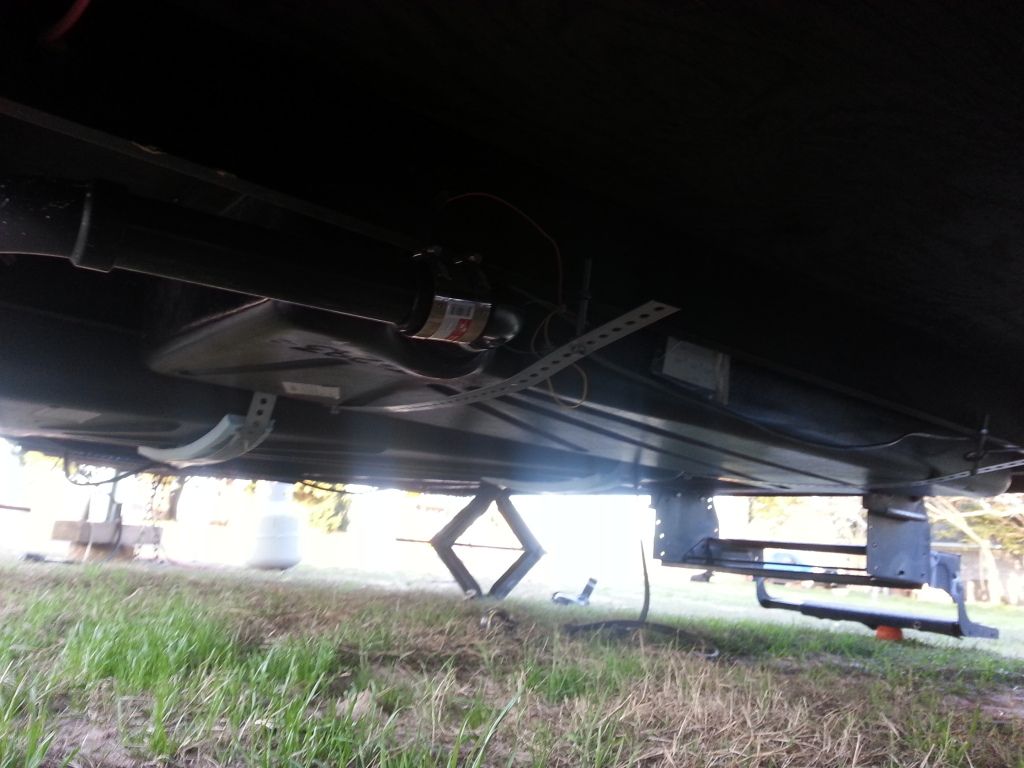

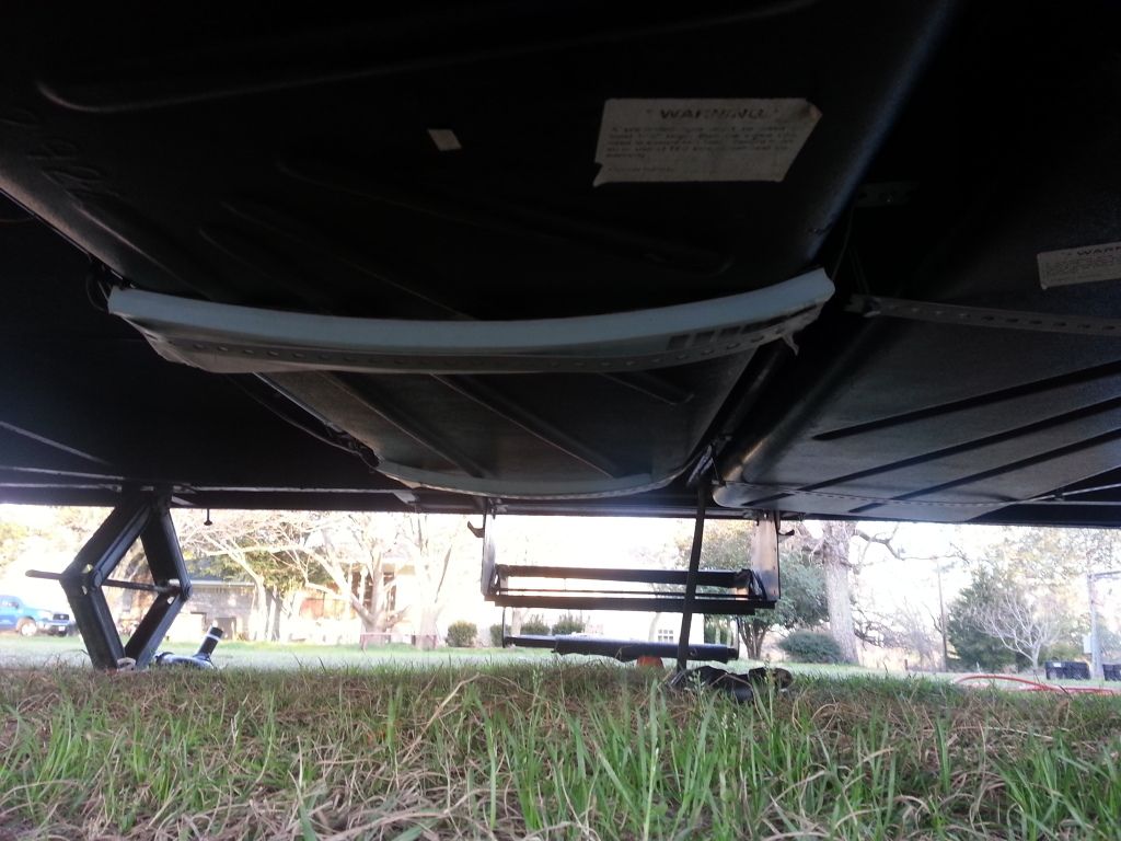

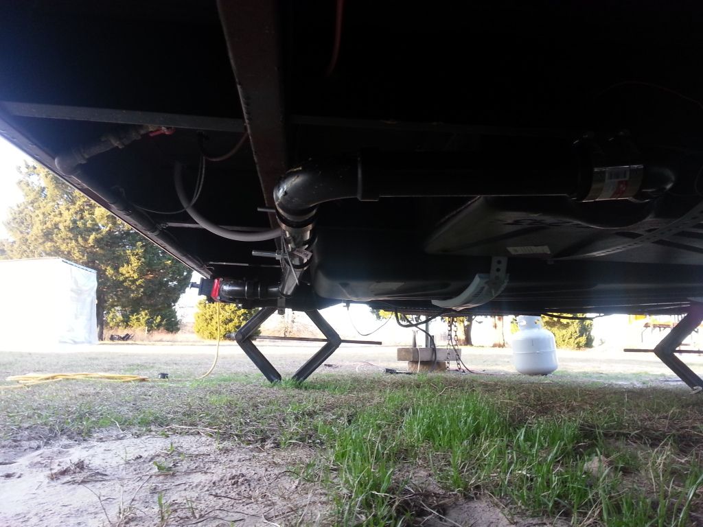

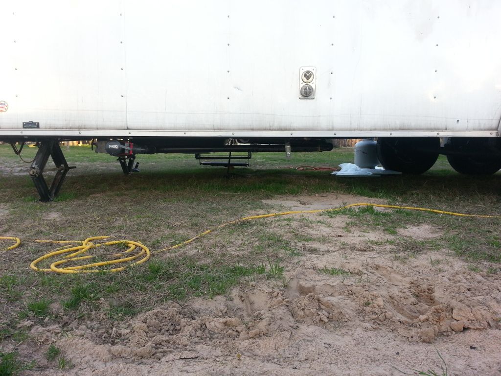

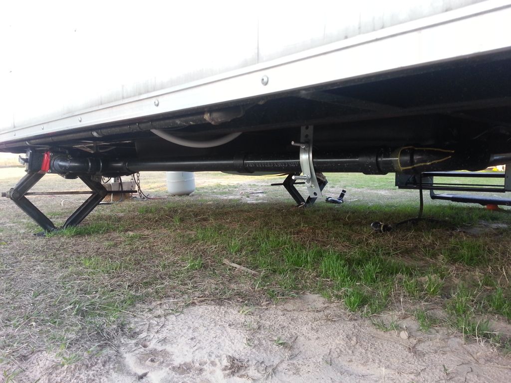

Postby DTCOOPER » Fri Feb 01, 2013 10:23 am
Here's some pics of my under trailer plumbing..
As you can see, the shower dumps into a P trap, line runs across and Wyes into kitchen sink drain. That line drops into grey tank (furthest back), then dumps into dump valve with black water.
