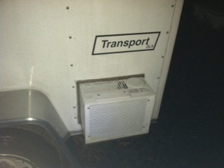

Here is my solution. The hole is level with the floor, so I attached a piece of marine plywood like a 'diving board' bolted through the floor inside. It's very strong and low profile. In addition, the little window unit only draws 500 watts, and can run on the smallest generators. It's pretty much identical to the unit suggested by the OP. I needed the roof space for solar panels.

Postby subterran » Tue Feb 12, 2013 11:04 pm
My trailer is so small (6 x 10) that so long as the airflow is not obstructed (such as when the folding bed is down) it does fine. Would I like to have it higher? Sure, but the elegance of the overall solution, strength and durabilty combined with a small fan makes the compromise worth it.
I can say that I was very tempted to go with a 'petcool' 2500 btu so that I could maybe run on solar, but I'm glad I didn't. It does need all of the 5000 btu's that the little window unit puts out to keep up in these Georgia summers.
