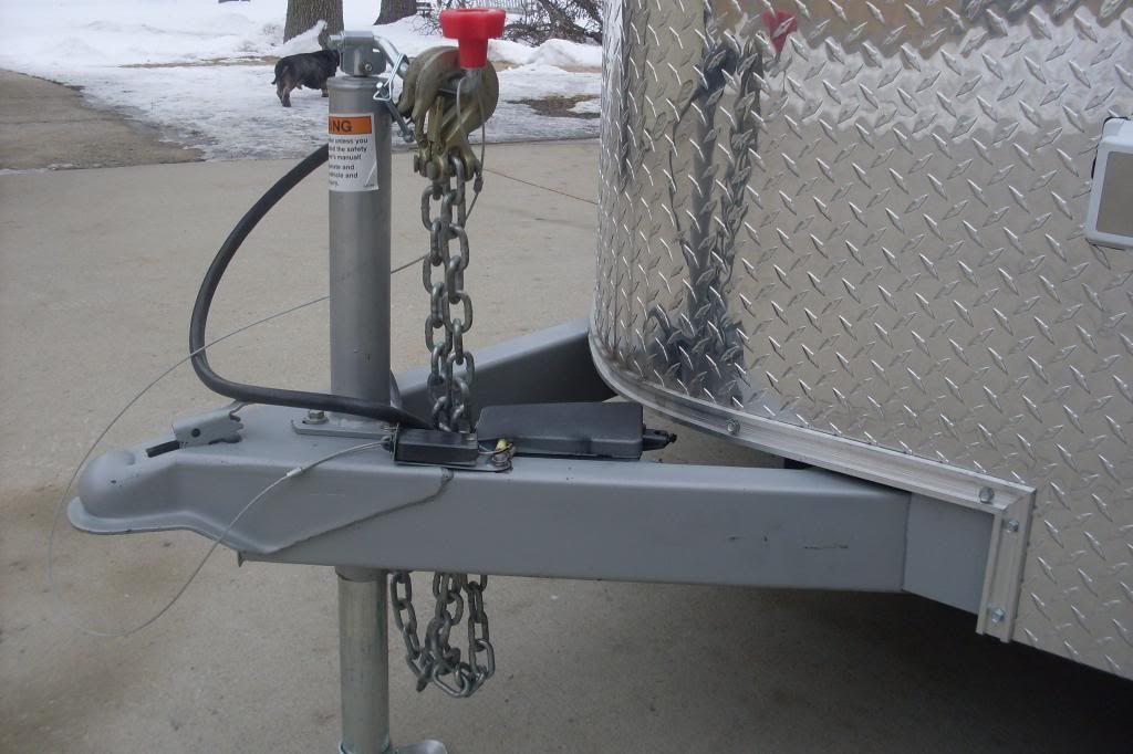

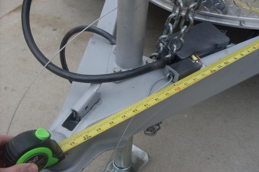

Found an issue with this V-Nose that I did not anticipate.
My weight distributing hitch will not work on this trailer. Because of the way the V comes forward on the frame the Spring Bars are way too long. Shortening them won't work as there isn't enough room on the left side of the frame to attach clamps too because of the 12v battery for the breaks. I have contacted Curt and hopeful that they will come up with a solution.

Postby hankaye » Wed Feb 27, 2013 11:28 am
Keystone, Howdy;
Quick question ... How many RV's do you see with the 'mini 12 volt battery???
Ya don't as their brakes are wired to the House battery(s) of the trailer. If yours
is inside then all you need to do is re-wire the brake wires to it and eliminate the 'Mini'
Or you can move the 'Mini' indoors.
