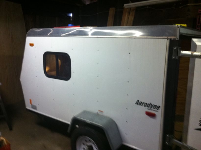

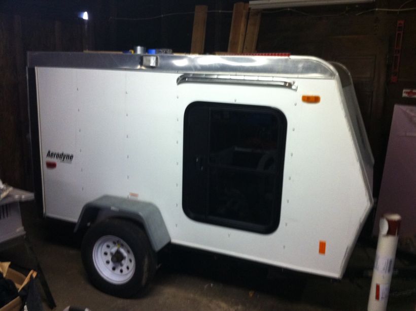

Ok so I got it insulated today. I used 1/4" insulation and tripled it so each section has a total of 3/4" insulation in the walls. As for the quality of this build by Homesteader they really put this together well. The walls were sealed to the floor with caulking and I didn't do the nose because I didn't want to mess with the structural integrity. When I tried to remove the passenger side wall you can see there is some damage to the front top corner. They really have those walls sealed and wedged in the front corners. I will cover the sides and nose with paneling and put some insulation behind the paneling if I think it's necessary. Windows will be put in in a few weeks after I decide on them. Leaning toward a 14"W X 16"L that will fit in between the studs toward the nose side of the wheels. I had to score the sealant on all sides and I forgot to do it where the damage happened so chalk it up to a lesson learned.Image Image

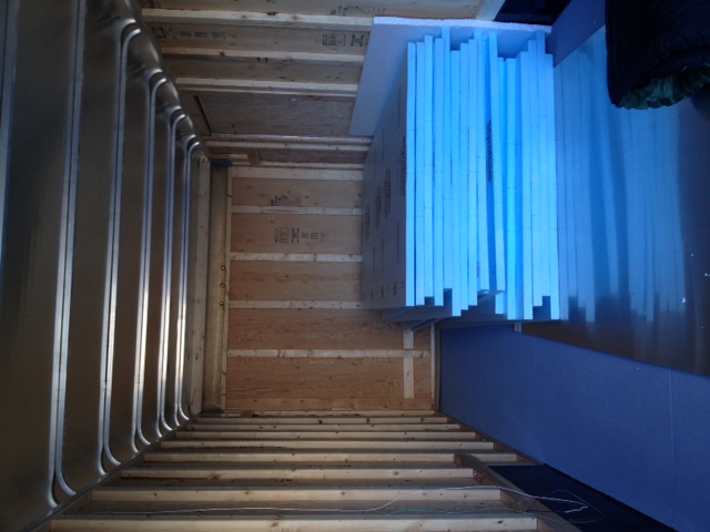

If you want the worlds best insulation, then I would recommend a solid sheet on the walls, roof, floor, ceiling & doors.
the wood studs and windows make a large thermal break. :cry: :cry:
Im using 2" Dow Blue board in my new build, "Over the studs" with about 3 x times the standard amount most guys are using.
Since your unit is so small you body heat should work to heat your trailer down to 10 deg if you do it my way. :D :D
below is about 1/2 of the insulation my 7 x 18 will require.....
I figure it wont need heat down to 10 deg "just my appliances" and body will heat the joint
and only use about 2,500 - 3,500 Btu cooling in 100+ deg weather.
