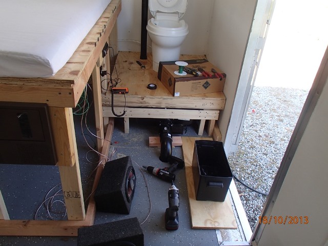

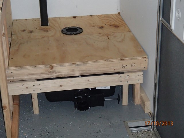

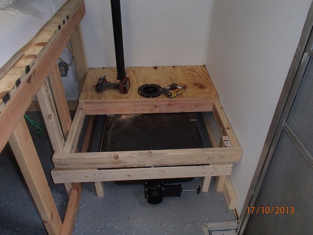

Postby jhamihvfd21 » Sat Feb 08, 2014 9:51 pm
Here is how i added my tank. I am not done yet going to close the bathroom in and make a folding step to cover the drain.
