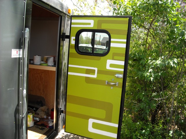

Thanks for the info and comfort that this will subside over time. I intend to have doors/windows open when camping in warmer weather and I intend to paint with an interior, latex paint to try to help "seal" in some of the odors. It doesn't really smell like just wood odor and it does remind me of the odor of preservatives used in biology labs. I was always told was formaldehyde. It might not have any relation but it does remind me of that odor.
My thought process in regard to the paint is spot on with your opinion Muddybike. I like the looks of paneling but when you consider the added weight and likelihood of introducing more material that is almost guaranteed to off-gas more, the paint is a no brainer for my style. So, I am going to get creative with my paint in an attempt to mittigate the loss of aeshetics of wood paneling. I am going for a funky, 70's, retro look. I've always wanted a 70's theme room in the house but really can't justify the expense right now so I am going to get my fix with the camper walls. I will post photo when I figure out why my SD card slot isn't working.

rollintent wrote:Image
Is that the paint or photoshop? Either way that is cool!
Re: Cargo trailer plywood odor/fumes
Postby rollintent » Fri May 03, 2013 8:15 pm
It's paint. I laid the white down first and masking taped, then the dark green then another round of masking tape, then the lighter green then pulled the masking tape. I wanted it to be "over the top" retro. I am very pleased with the way it came out. I am thinking about adding some bright orange and yellow flowers sparingly to the light green to give it that "what the hell were you thinking" look. My guess is most people will love it or hate right off. It's for profiling purposes. 8)
I started out looking for some of the old original wall paper from the 70's with gaudy orange and green flowers or something. It is very expensive when you do find it. So... I decided to go custom with the paint. It will take a while but its all for fun!
