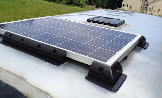

Postby digimark » Thu Jun 27, 2013 1:38 pm
Wel, it took me a while to get the screws and washers I wanted. This morning I walked out to the trailer and got this done:
1. Cleaned the trailer roof surface and the ABS mount surface with 99% IPA and let it dry/evaporate.
2. Pre-drilled a 5/64" pilot hole in each screw location on the mounts.
3. Laid everything out with the panel sitting on the mounts for position. Marked the locations with a blue magic marker.
4. Applied the VHB tape as we'd discussed, covering the entire underside of each mount. I pressed them hard with my
thumb.
5. Pulled the tape seals and, after positioning them in their locations, pressed down hard on each mount multiple
times. I hope that's good enough for adhesion, plus leaving the solar panel sitting there, because I couldn't think of
a way to add pressure over time without standing on the ladder for too long.
Here's a picture of the result. Note the panel is just resting on the mounts but is not screwed into place. I'm going to
wait a day or two for the tape to set up as best it can. Then I'll be using #10 stainless steel self-drilling, self-sealing
screws. (The washer has a neoprene membrane which will help prevent it from working loose.)
With the slight curve in the trailer roof I was worried that the panel wouldn't rest flat, but I can see there is some
flex. If the VHB tape holds like it's reported to... then I think I'll be alright.
