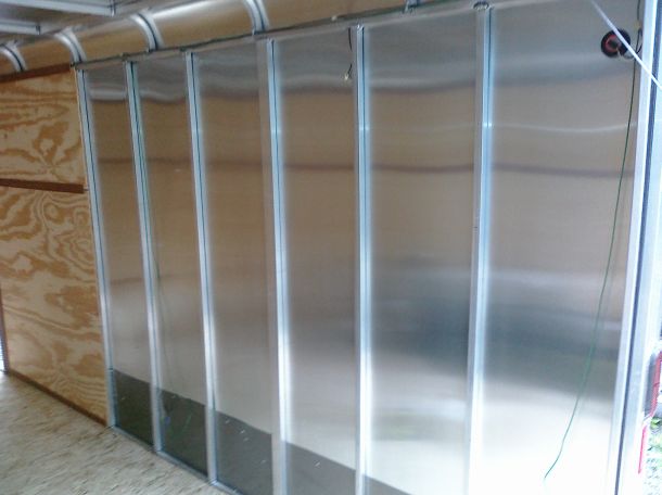

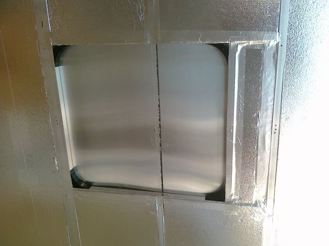

I got started on the window frames today, not much but a start all the same :thumbsup: . I am going to be riveting in the frame pieces so I don't have to weld so close to the bonded skin and insulating each section as I go.
made the cuts with a air cut off wheel and used a wire to separate the skin

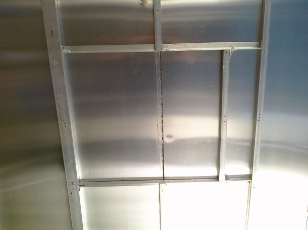

I decided to rivet the tab pieces on and then alumaweld the pieces of the frame before screwing the frames in place it should support the window well and is pretty strong, I used 1" angle and notched it to fit over the frame tubes.
rivets, alumaweld, and screws
strong as is
test fit the locking ring

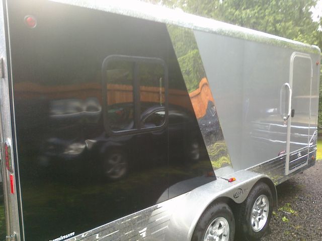

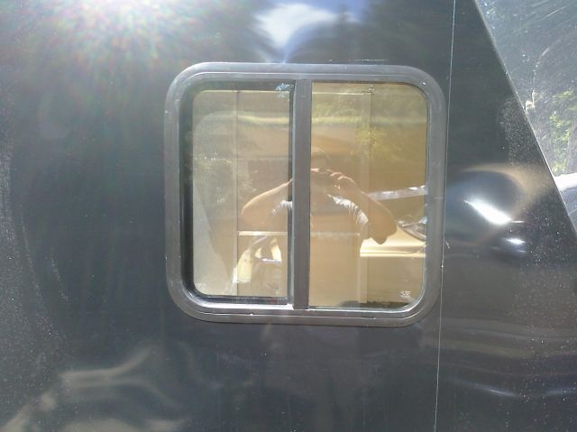

Postby poordad » Sat Jun 22, 2013 6:20 pm

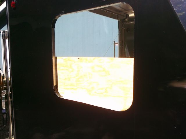

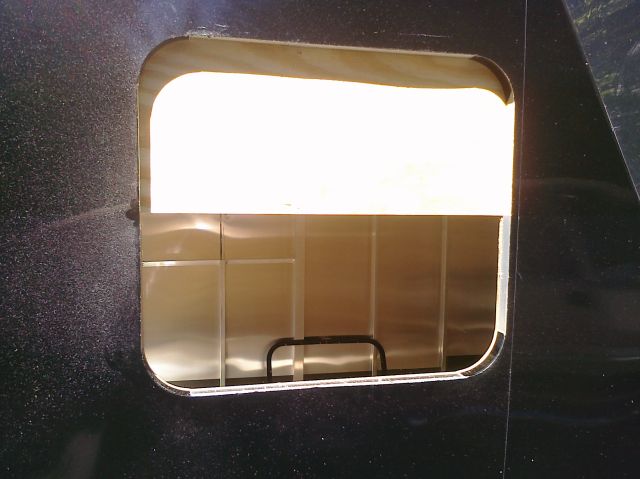

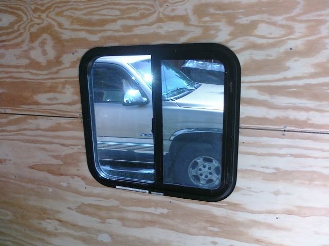

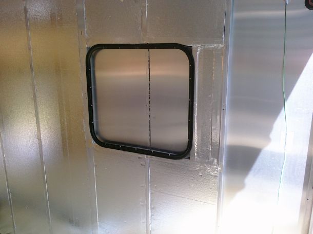

I was able to work on the windows some today and got one window in as well as work out some installation techniques at the same time :) only three more to go ;)
I followed the frame with a flush cut router bit first on the skin then mounted the plywood and followed from the inside :NC :thumbsup: only a couple of small scratches so I am happy so far :)

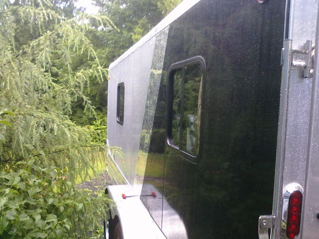

Postby poordad » Sat Jun 22, 2013 6:21 pm

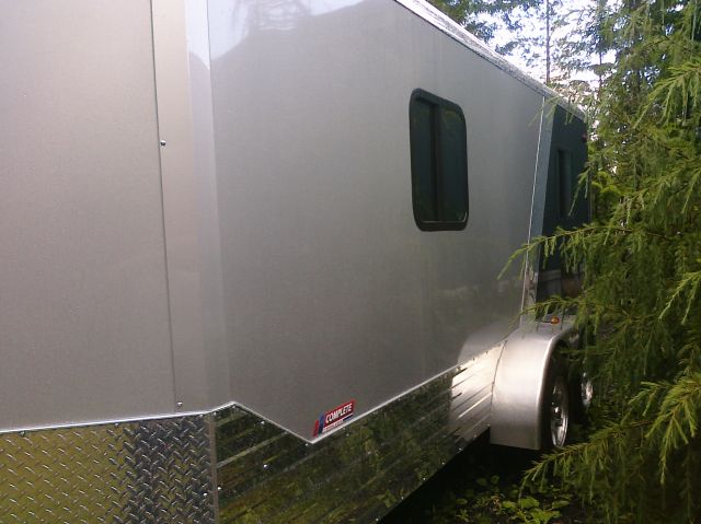

a couple of pix of the mounted window

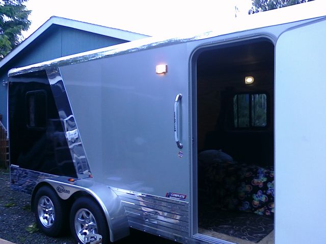

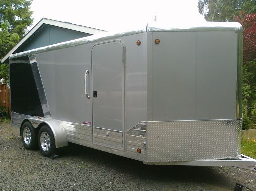

Postby poordad » Tue Jun 25, 2013 10:18 pm
I got three of the windows in and the last one goes in the door so I can get to that when I get the chance so for now I'm going to focus on finishing the insulation and paneling for an upcoming camp trip :)

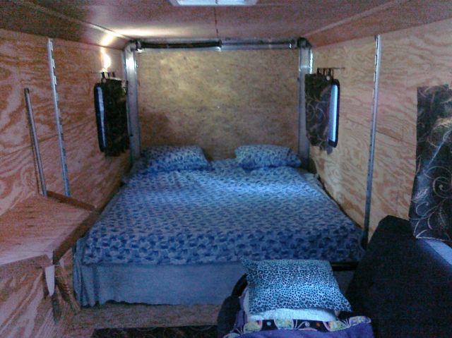

Postby poordad » Sat Jun 29, 2013 11:23 pm

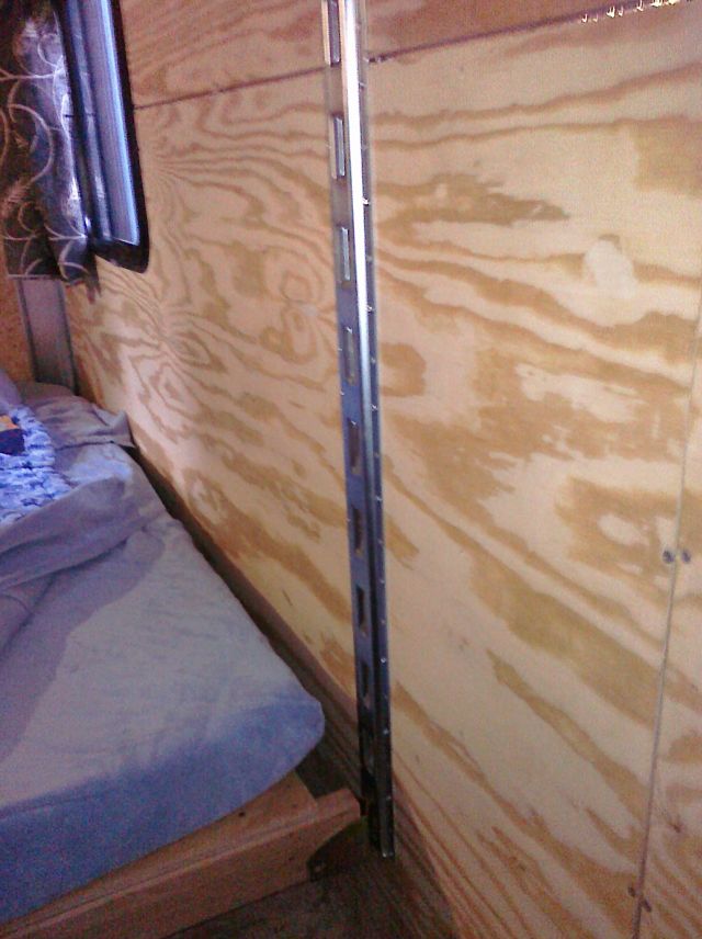

well as mutch as I would love to start working on some cabinets and take on the plumbing and wet bath the weather is beautiful and I finished the bed, insulation and rough paneling in so we are going camping instead :) :beer:
