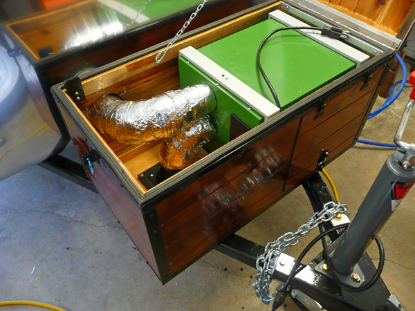

This is the third generation of what was originally the PetCool. I have the PetCool in my teardrop and it works very well. It will cool my teardrop down to about 75 degrees on a 100 degree, 50% humidity day with the teardrop in direct sunlight.
On these units the condenser, compressor and supply fan are matched so you don't have to worry about the coils freezing up as sometimes happens when you restrict airflow on a window shaker unit.

Actually I stole theirs, OK not really because I saw a number of variations on this theme at a couple of TearJerker gatherings, had a Pet Cool the predecessor. 2500 BTU not enough coolth.
86016
Or you can do this for three hundred less, there is a write up of how I did it.
80999

5000 btuh will probably work if you have substantial insulation, if you break the thermal bridge from CT exterior metal to the metal studs, and if you don't need to cool down the CT in a hurry.
The PetCool we have is 2500 btuh. I installed it in the tongue box. The supply side is ducted through the front of the teardrop up through the front headboard. The return air grill is located in the rear bulkhead and the return air is ducted below the the teardrop back to the tongue box.
While I really like the setup in our teardrop, if I were to do a CT conversion, I would use a window unit with probably around 8000 btuh permanently installed in the CT.

Clint,
I used 2"x3" aluminum downspout. I wrapped the downspout with 1/2" foam insulation. Then I split a 3"x4" downspout on one side the length of the downspout. I wrapped this around the smaller insulated downspout. Pop rivets and straps keep the split part together. Then I mounted it to the underside of the floor.

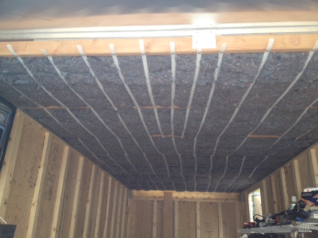

I hope my 4" R-19 will be enough to have 5000 Btu cool my 7 x 18
