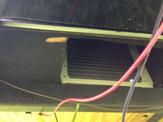

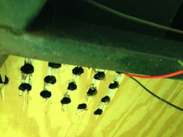

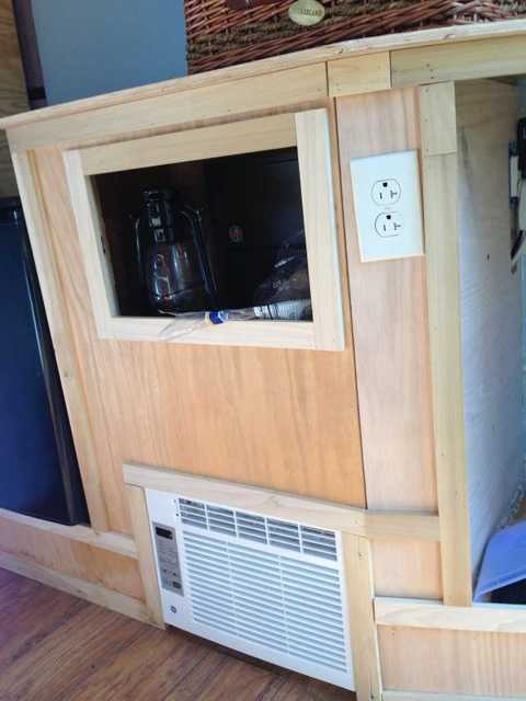

I built mine into the cabinet and vented it through the floor. I have a 6x10 and it seems to work great so far.
Inside is mounted right inside the cabinet. I sealed the floor and cracks under the cabinet with that rubber sealer in a spray can.
Not a great pic, but this is looking up underneath the trailer at the exhaust from the unit.
These are the intake holes on each side of the trailer. I just need to put some sort of mesh o keep the bugs from building a home up there.
