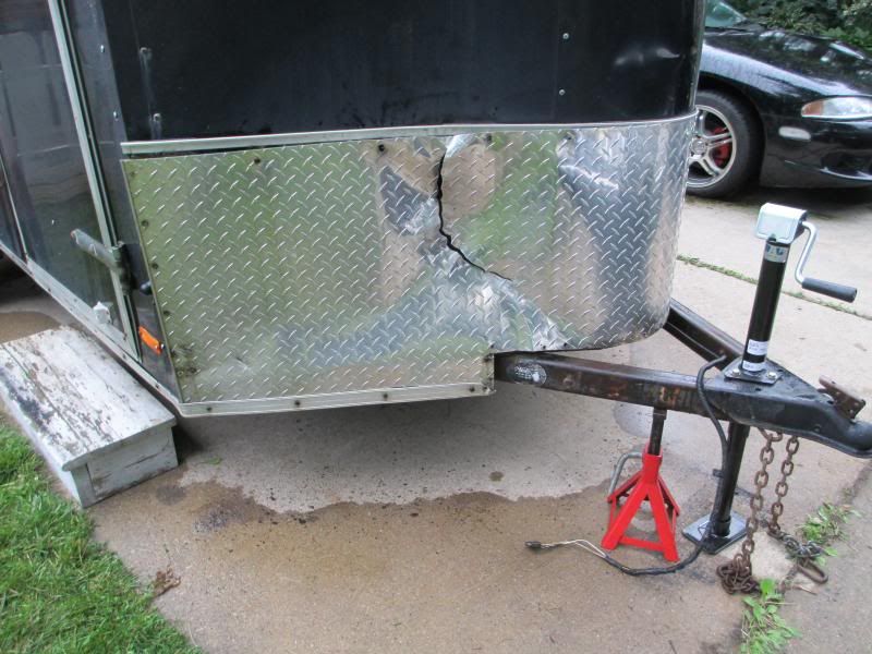

When I bought the trailer there was damage from the previous owner. He had jack-knifed during the winter. The diamond plate was torn, upright was bent. My dad and I spent about a week going through it, repairing what needed to be repaired. The fenders were only held on by drywall screws and silicone! We took the paneling off and insulated the walls. Since I will be hauling stuff and intend on making rolling boxes for Trade Shows I put 1/2" plywood on the bottom 16" of the walls. This also allowed us to through bolt for the fenders. Dad painted the inside with some left over light tan he had. We started building the cabinets in the front.

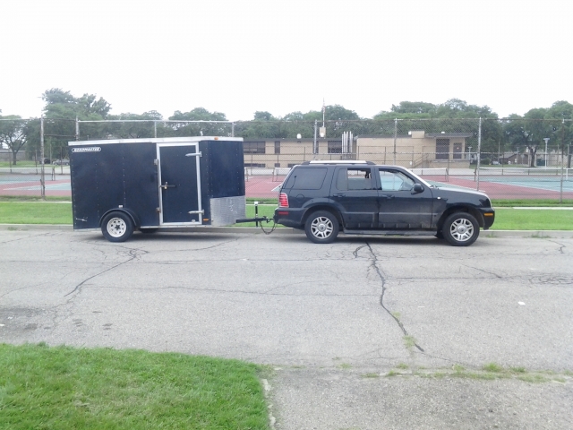

Here it is hooked up to my current tow vehicle. A 2005 Mercury Mountaineer with 4.0 V6 with tow package. It tows well enough, but only gets 11.6 MPG at 70 MPH. On the other hand I got 14 MPG on the return trip at 63 MPH.

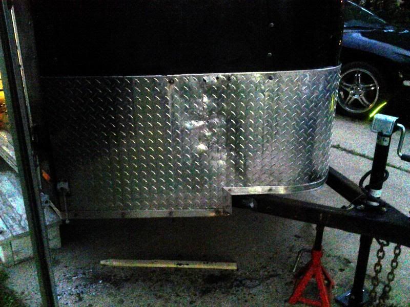

I didn't really want the spend the money right away on new diamond plate at $126 per sheet if I didn't have to so I could do other things. Where the plate was torn it had stretched. That allowed to me to overlap and silicone to seal.
Here is the repair:

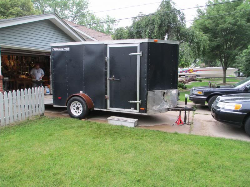

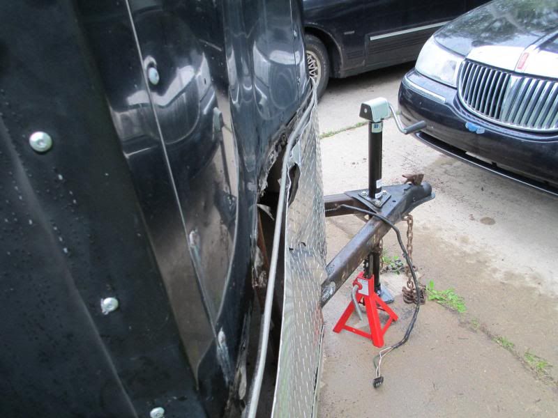

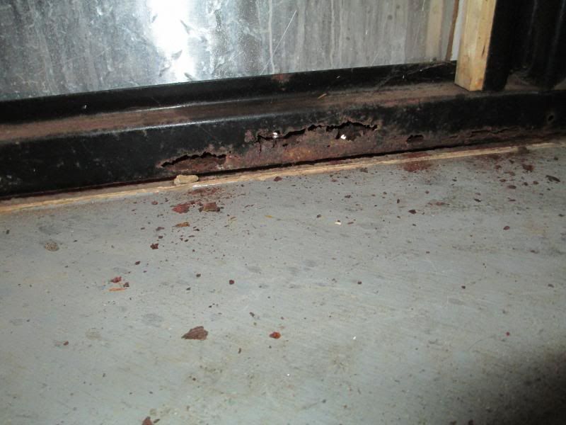

I finally got the pictures of my trailer from when I first got it with the damage.
Driver's side, notice the rusty fenders. This is with the new jack.
Passenger side where the damage to the diamond plate is:

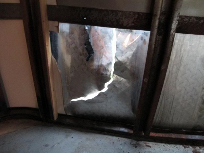

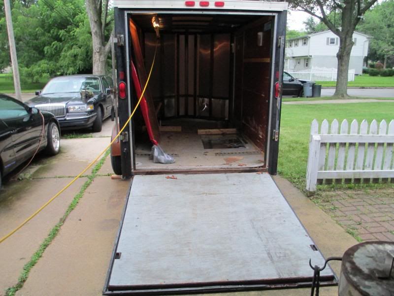

Gutting the inside paneling for insulation, replacing the bottom 16" with 1/2" plywood as a base board and repairing the front upright and sole plates. The front two were rusted so I backed them with 1" angle iron.
Damage from inside. The upright and sole plate were bent back into position here.

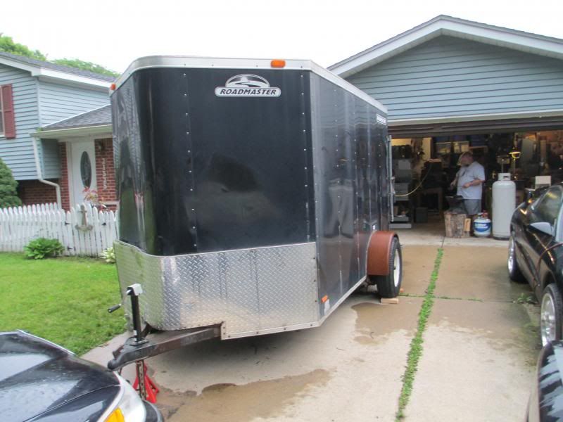

Repairs done outside:
I didn't get some photos of the build due to the fact that my retired dad did a lot of it while I was working.
AND YES my brother is playing on our anvil and forge set up. He is a knife maker.

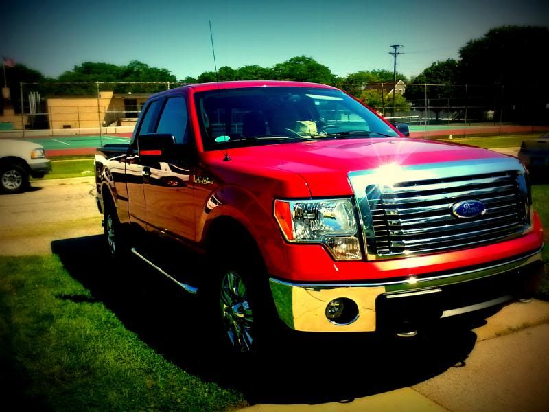

Postby Jkindy » Fri Aug 30, 2013 8:00 am
I got a new tow vehicle! 2010 Ford F150, 4.6L 3V Supercab 4X4. Only 35,000 miles and extended the warranty to 100,000 miles 5 additional years. It still has the "New Car smell" too! I can't see anything wrong with it, no dings scratches or wear marks. This will pull my trailer a lot better than my Mountaineer V6 for sure.
I will hook up the trailer this weekend to test everything out for my trip to Missouri next week.

Postby Jkindy » Sun Sep 01, 2013 9:55 am
Here is the new tow vehicle hooked up. It felt soooo much better pulling it with the F150. I could hardly even feel it back there, especially when pulling out into traffic. The engine brake is a great feature and will be nice on the highway. The big test will come with next weeks 1400 mile round trip to MO to pick up my son and bring him back home after two years.
