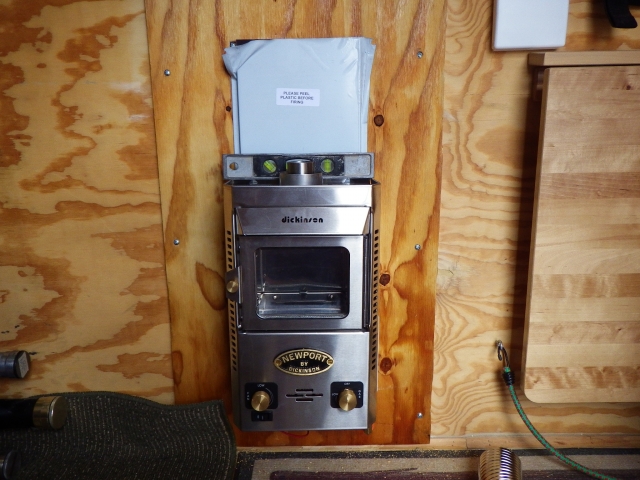

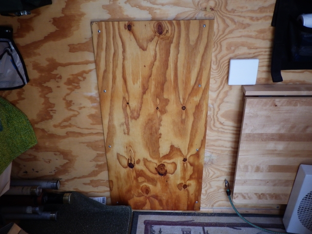

I screwed a backing board onto the wall for support and mounting, and because that's what BC DAVE did!

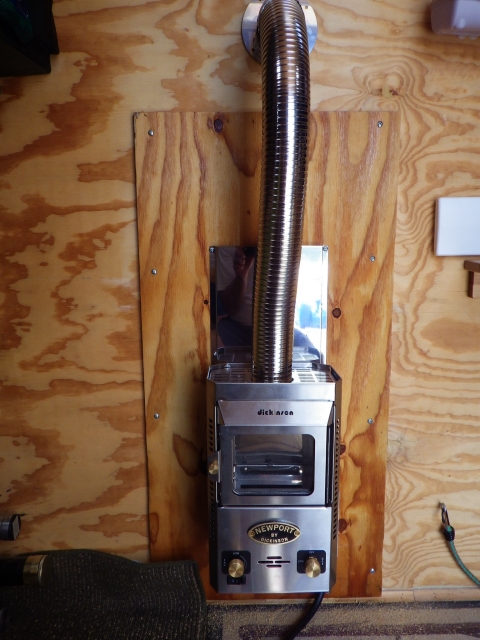

I mounted the heater to level it, check for location convenience/access, and for measurement purposes.
Vent pipe attached for measuring/fit

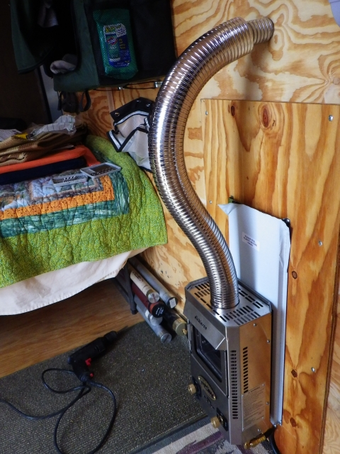

Vent pipe bent into shape to exit side of trailer and mark the dreaded 3-inch hole location.
Side view of vent pipe

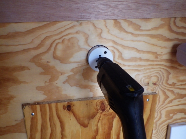

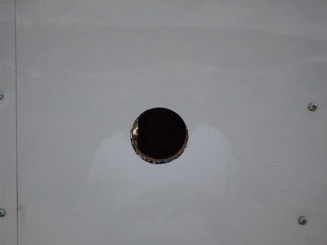

Oh my God. This was the hardest part! Drilling a 3-inch hole through a perfectly good wall of the trailer.
Right through the wall and outside skin! Now I'm committed.

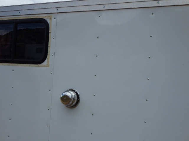

Outside vent cap screwed on.

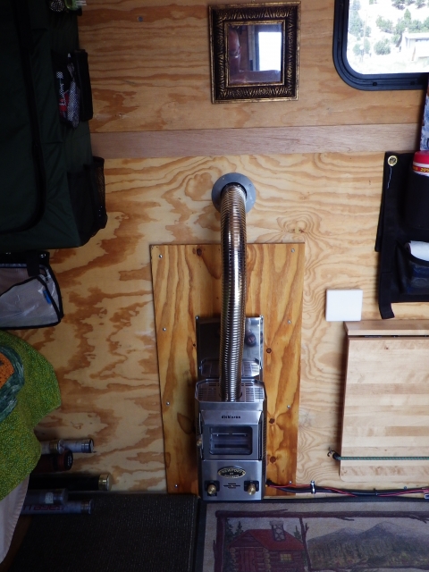

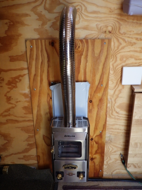

In she goes, pipe secured inside and out, and bent to shape and fit tightly. DONE! :D

pchast wrote:I'd love a side view of the finished product.
Did the flex pipe stick out far into your space.

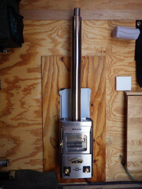

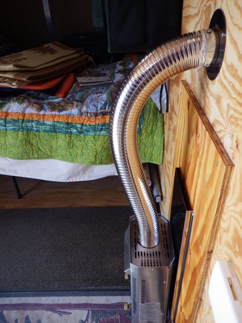

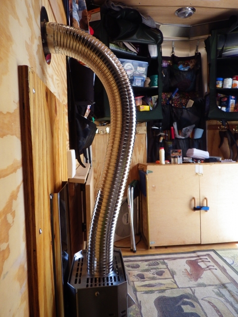

Not hardly at all, only 1" out from front of heater. Here's some finished photos.
The flex pipe only sticks out one inch farther than the front of the heater. Heater is 7" deep from the wall, outside of pipe is out 8" from wall. It looks further in the picture, but I measured it! Which brings me to the answer for Cindy of why this heater?
