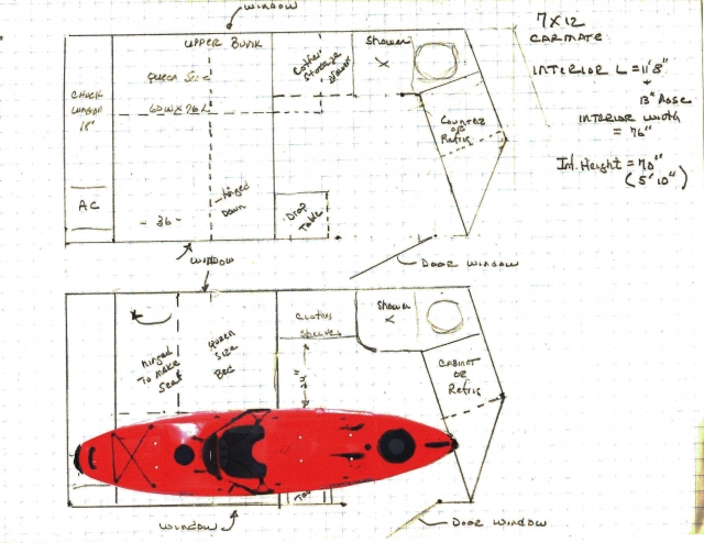

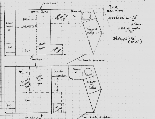

This sketch shows the layout for the 7x12 trailer.
The top one is with the upper bunk on the driver's side and the bottom shows it on the other side.

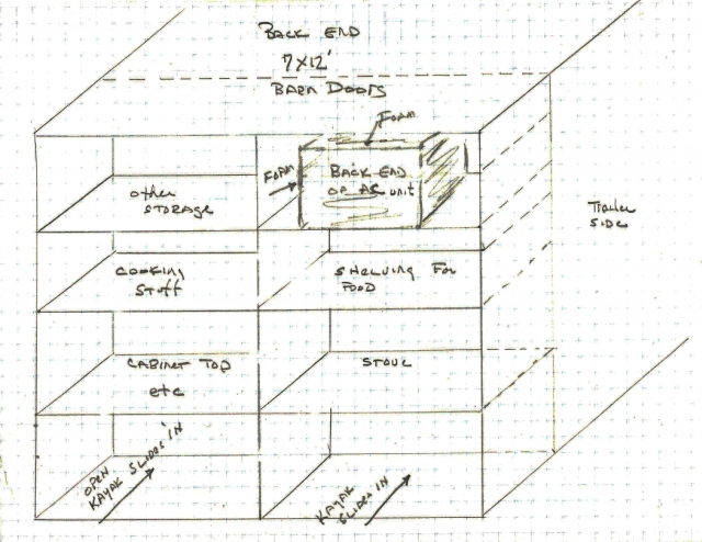

This next sketch shows a sample of how I will carry a 12 foot kayak. It will slide under the Chuck Wagon shelves in the back and under the main bed and then protrude into the cabinets (will allow for this in the construction process).
This last sketch show the Chuck Wagon concept with a barn door setup. It is not dimensionally correct, just a concept to show how things will roughtly go together. It shows an AC unit on the top which at first will be used with the right barn door open to test it out and then hopefully I will cut an opening in the door for the unit to "breathe" through. The opening will have a hinged door for traveling done the road.
The kayaks will slide under the first shelf and when not being used, the openings will have a plywood cover which slides in and makes a secure storage area for coolers and the like.
Ok, comments, suggestions and critiques welcomed!!

Just a little FYI , your 7 x 12 is only 76" wide
My unit is 80" ..... This is What you generally need for a queen mattress
If you are short & use a soft roll mattress then 76" may work.
Jerry

Both my units are 80 wide , so your trailer is a little smaller then the standard 7 ft for some odd reason.
7 x 12 = 84" ...... So inside is generally about 80"
So maybe a 6 ft .... Is also short of 72" ?

Any way, I went to CarMate's web site and see 76 in interior width posted for some models and then 80 inches on others. All 7 footers.
I wonder if it is a miss print or if they may actually have different models with different widths. I cannot see where they post the exterior widths, so I cannot verify it using that measurement.
I think this is a great catch on your part and will definitely take some more homework on my part.
