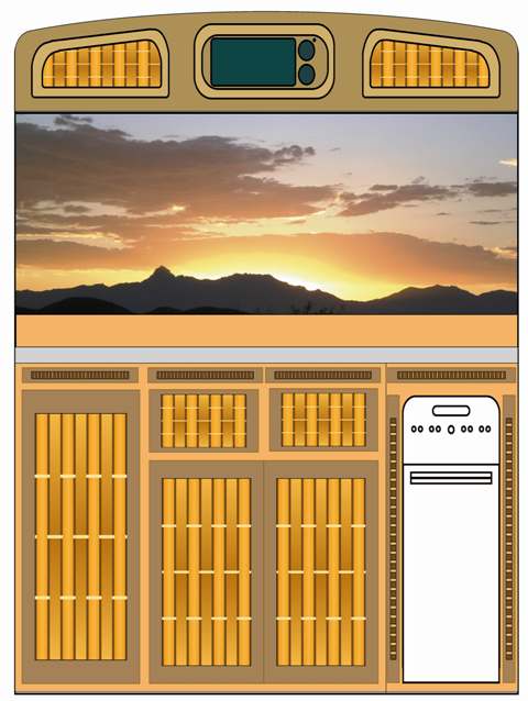

This site has given me hours to study the average build for the cabinets and it seems that in lieu of the box cabinet that is used in homes, the TD's use the trailer walls (front and sides) for the box and a face frame is added ... wa la a sturdy cabinet :twisted: I guess, I am going to lay out the cabinet face frame and divider framing, then add support struts to the three walls to tie everything (including the top) together. I believe that will be strong enough ... mostly cab grade 3/4 and 1/2 inch plywood and hardwood support struts. The cabinet doors will be simple shaker frames with braided slats to match the drawers. :worship:
I added my idea of what the front of the cabinets might look like (the art changed size to long and skinny when I converted it from a pdf to a jpg) - my wife wants an A/C in the trailer; the drawing shows a 5K btu room style A/C replacing the right side cabinet space. Dump hose insulated and routed through a vent to the outside. The overhead includes an electrical panel that will probably be greatly reduced in size. The backsplash is a photo I took of a mountain near where I grew up mounted forward of the galley counter. Is it time to have a cold one yet? :beer:
Well earnest, what are your thoughts...

I followed the lead of others too by incorporating the walls into all of my cabinets and storage too. They are very strong and work well. Its great you found the room inside for your galley. :thumbsup: You will enjoy it.
I am doing a combo build. I will mostly cook/eat and everything else but sleep outside, but in case of weather I will have a full galley inside too. I agree, it really sucks taking a weeks vacation and it turns into a week of rain without having a good place to get out of it.
If that is a portable AC unit you have drawn, (IMHO) you will be disappointed in it. I was considering that route until I read several post from many others that have tried them and were not happy with them. The main one used seems to be a $100-$170 5-6k window unit that is removable or permanently mounted. The other option of course is a rv roof mount, but it is mostly passed over due to high cost ($500+). I have been using a removable 5050 btu window unit mounted just below the roof line in the side of my CT. It cools my CT from 98-78 in about 1.5 hrs. If I turn it on in the morning, it maintains the temp at whatever it is set at with no problems. I am so glad that I followed the lead of others again!!

Thanks for the tip on the A/C; it calculates to be large enough, but advertisements do not always meet the reality of it all! Because I am hoping to use the CT for fair weather (Coming from Southern Arizona, that means a daytime temp. below the 100 degree mark) and generally in the dry regions, it usually cools down nicely when the sun goes down; especially if you can find a spot up out of the canyons! Up a bit on the hillside, there is usually an evening and morning breeze (up and down) that really helps – the canyon bottoms are often prettier (except dangerous in the rainy seasons), but there is a breeze and less bugs up the hill. See my Newbie post of my current camping vehicle (a blazer) and where I parked ... the breeze blew off and on all nite, making an otherwise hot August night, in the rainy season in Southern Arizona, bearable! :applause:

Thanks for the comment on the cabinets! I have been wondering which way to go and now that you have confirmed building without the box, so to speak, I'll start that way! I priced some plywood yesterday a HD, but want to compare quality and prices a Lowe's. Lowe's is usually more expensive, but their wood is generally a little better quality, at least here at the Phoenix stores I go to. :NC
