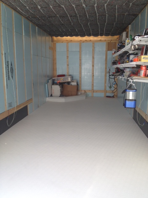

Postby OverTheTopCargoTrailer » Sat Sep 14, 2013 10:15 am
like this :D

Postby roadinspector » Sat Sep 14, 2013 8:16 pm
103556
1" foamboard supported by 1x4s
103561
1/2" foamboard placed between 1x4s and covered with 1/4" plywood. 1x2 installed to cover plywood joints. It didn't cost very much and works very well. If you are asking for insulation purposes,
96118
I also painted the roof with Henry Solar Flex white paint. It reflects lots of heat away from the CT.
110727
My CT has an arc at the roof line. I used 1x6 long ways to create a channel for my electric. Not really happy with the 1x6. Didn't come out as good as I really wanted. I may put that on my "change later list".
Good luck on your build!
Earnest

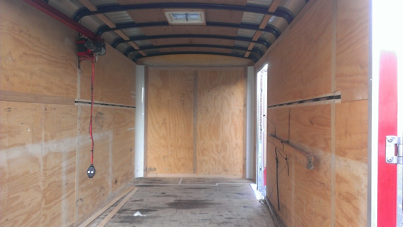

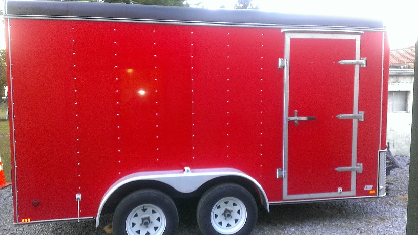

Here are a few pics of my trailer I want to remodel on the inside. I would like to add cabinets and a bench in the front, possibly cabinets along the top of both sides.
Like I mentioned, I want to also run additional 110v wiring for lights and recepticles. I suppose now would be the time to run the necessary wiring for a future roof mount A/C unit.
Jeff

Postby hankaye » Sat Sep 14, 2013 11:32 pm
jmayaa, Howdy;
Looks like an empty canvas ready for a masterpiece to be applied to the interior.
By the way, what make trailer is it?

Postby jmayaa » Sun Sep 15, 2013 6:41 am
2005 Danzer 14'
I ordered it new, has 7' ceiling height in it.
