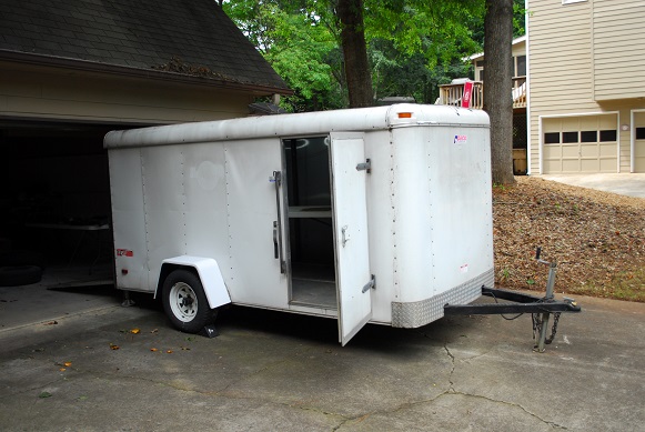

Its a Interstate load runner 6x12
My wife never could get comfortable in the little TD so here we go :twisted:
My first issue is how high the trailer sits up; I think I am gonna swap spring for torsion axle (with brakes) and maybe shorter tires.
Trailer has barn bars and I will set up a galley/storage area against a partition wall. A queen size mattress will sit on other side with storage underneath. (I will insulate and repanel inside also). Compact chem toilet closet and storage at front end of trailer and maybe some hammock or bunks for the kids. Electric will be pretty minimal.
Thanks to everybody for all the great info and expertise shared here :applause:112729

Looks like it has a straight (non dropped) axle. Some folks want that for the ground clearance for bumpy road/trail travel. A torsion axle can be ordered with just the right degree of "lowness" to suit anyone. And if you go too low a welder can always insert spacer blocks to lift it some. My wife does not like the lack of vertical space in a TD either. G/L. As for shorter tires watch the load capacity of them.

When looking for your 'shorter' tires, the trick is in the sidewall height usually expressed as the 78, 75,
80 or 60 number which is a percentage of the width which is the R235 or whatever number is the lead
number of the tire you are considering.
Maybe this will explain it better.
http://tire-size-conversion.com/how-to-read-tire-size/
Good luck.

Looks similar to mine, and I had the same issue. I swapped the straight axle for a 4" drop axle. Extremely pleased with the conversion and it was very simple. The drop axle I bought did need to brackets welded on (which seems common), and I ended up replacing the fenders to clear the raised wheels and because they were just beat up. My goal is to fit my trailer in the garage, which was part of the reason for the drop axle, but it also feels like it tows a little better, and I appreciate the lower step up height when getting in and out of it.
I went with the leaf spring axle due to cost and the ease of install. It was a couple u-bolts to remove the old axle, and a couple more to reinstall the new one. Other then hitting up a friend to weld on the brackets (took 15 min) it was a couple hour job. That included cleaning and repacking the bearings, and painting the metal where the welding was done.

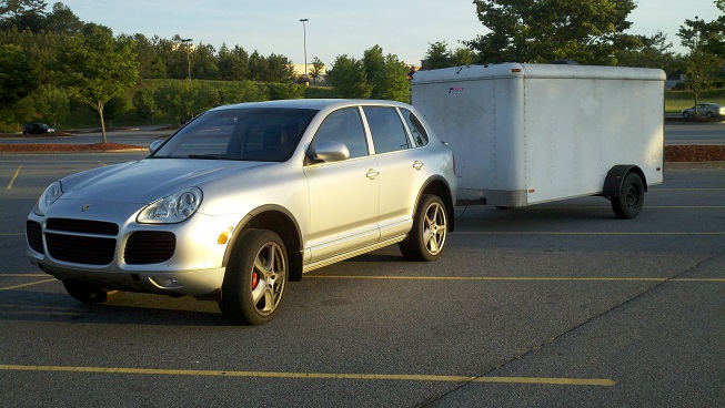

Your gonna have to do a little work to get it to match with your super nice car :thumbsup:
I'm seeing something that looks as cool as a T@B
Can't wait and see more pictures as your building it.

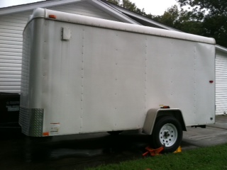

Ok, I am reading lots of posts and have some ?s:
1. I have barn doors on the rear and wonder about removing and making a flat panel hatch that would open up like a TD (my galley will be in the rear with a wall separating from rest of trailer ) the doors seem unnecessary
2. Anyone use hammocks for kids?
3. Do most people end up sealing the roof?
4. How low do most set their trailers? Is there a rule of thumb for ground clearance?
I have a RV slam latch to install tomorrow and starting planning :)

I think I have seen a conversion here that is simular to what you are talking about. Where the barn doors are, he replaced with a hatch door that hinged up for galley access and a cover. It looked like it would work rather well.
I do not know whether most seal their roof or not. There are several folks that have painted their roof with elastrometric paint to reflect heat. Sealing it better is just a side benefit of the product. Generally the metal roof of a CT is not susceptible to leaks like an RV is. :rainy:
