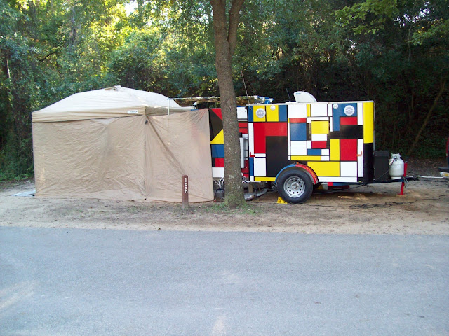

New here, and mine is not nearly as professional as others, but wanted to share it any way. It took about 5 months to get to it's current state. It is about 90% complete, and we took it out for the first time this last weekend. Hope you find it entertaining, and appreciate all the information on this site!
This is what it looked like the day we brought it home.
I don't show all pics of the build here. You can view them at http://goodnuffandtuff.wordpress.com/. We built up the interior so we could use it as a wrap around dining table in the day time, then drop the table down and make it into a bed at night. The interior consists of three u-shaped benches with hinged lids to store stuff underneath. A table top with steel-tube legs screws down into flanges in the floor to make a table. The table top can be broken down and set flush in the middle for a queen-size bed as shown in the next two pics:
This picture was taken before I trimmed the table to fit snuggly between the two side benches.
A 2.5 Gallon per minute propane hot water heater is plumbed under the trailer and into the rear door (inside has kitchen sink). It supplies hotwater to the shower through fittings on the left rear side (looking forward) for the tri-fold shower which stores on the left-side (looking forward) during transit
Marine speakers, LED flood lights, and AM/FM Antenna are seen in this photo. A Pyle USB/SD/AM/FM with aux in headset is inside the door
The kitchen is bolted to the door with steel L brackets, and plumbed to both cold and hotwater through the door. The 21" TV has a Western Digital Entertainment "ROKU" type box with 4 TB HD of movies and shows. The box with the radio has switches for floods, 12VDC and battery meter.
Tri-fold shower walls store on the side of the trailer during transit, and with the shower base can be set up in < 10 minutes with cold/hot water.
Full hot/cold shower with thetford curve toilet plumbed to hot water heater on door. The shower has a grey water "capture" pan under the base with a 12VDC water pump (2.5GPM, same as the shower) which pumps out the grey water either to a 14 gallon bucket or to the sewer access at site. If it is pumped to the 14 gallon tank, it is then sent through a 5 gallon sand/charcoal/gravel filter to the ground.
Hot/cold water runs through outside of cargo door into the kitchen sink.
The cold water runs from park source under the trailer to right side (looking forward) and is distibuted to the Hot Water heater inlet and sink cold water. It is "tee"'d at the park side inlet to feed to cold water for shower.
The hot water heater has cold water inlet split (top pvc) so it also goes to the cold water part of sink. The hot water output (bottom pvc) splits to go to the shower and the sink.
The pvc pipes running under the GNAT's rear deck supply cold water TO the heater, and hot water FROM the heater for the shower. I insulated it after freezing temps in SC cracked the pipes...
As you can see, with the pop-up screen tent we have 10 square feet of protected living space. The heavy-duty black nylon curtain allows the cargo door to remain open; it has weights in the bottom of the curtain to keep it on the floor, and is water-resistant and insulated.
View of the table top in table-mode. Leg's are steel posts bought from LOWES with steel flanges in the floor. Posts are screwed into floor, table-top has friction-fit holds to mount to poles.
Myrtle Beach State Park, Oct 2013...first trip in it...
Nothing like relaxing at the table in the morning, having a cup of coffee and catching up on the news (if you want)...the tv mount pivots 180 degrees so you can watch inside the GNAT, or outside...with a amplified antenna, you get all the free channels over the air...
https://www.youtube.com/watch?v=VzIvXX13Lk8
You can view the entire build at http://goodnuffandtuff.wordpress.com/

ValeriP: My wife designed and painted the GNAT. She used the Patridge family bus (which was based on a famous painting) and sketched it out, then pain-stakingly taped it out, painted it (4 coats) with roller brushes (the mini-kind) and then put 4 coats of wax on it.

As we will be at Myrtle Beach State Park in SC next week, I thought I would include a map of the park with "our" favorite spots. We have been going since 1993 and have carefully surveyed the sites over the years.
Our criteria are as follows:
- We always want a site with full hookups (electric, sewer, water)
- We prefer a site with privacy
- We prefer a site that has room on the trailer door side so we can set up our awning / tent.
With that in mind, the map shows "A", "B", and "C" sites, based on the three criteria above (keeping in mind all the sites marked by "A", "B", or "C" have full hookups).
http://goodnuffandtuff.files.wordpress.com/2013/11/2010-mb-state-park-campground-map.pdf
Hope it helps someone who has never been but planning on going.
