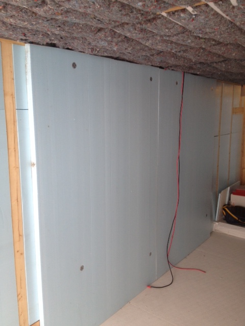

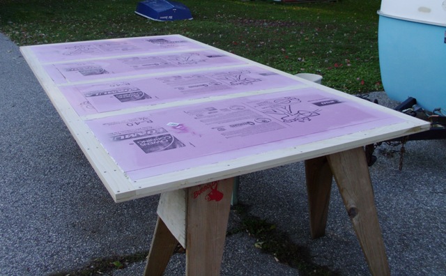

Postby OverTheTopCargoTrailer » Fri Nov 22, 2013 12:27 pm
Ice houses
http://www.fishhousesupply.com/icehousekits.htm
Built with 2 x 2" wood frame and 2 x 6" wood frame.....
Recommend Dow Blue board insulation :lol: :lol: :lol:
Do I hear OTTCT or CarMate like construction......?????
brother take me to the promised land......
double foam wall.JPG (99.53 KiB) Viewed 2490 times
door 3.JPG (117.45 KiB) Viewed 2490 times
