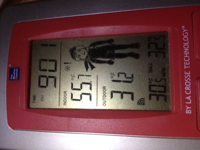

Last night it got down to 30 deg F.... Inside my trailer this morning it was almost 56 deg F
I only used my tv, fridge , sat recorder & body heat - inside a 7 x 18 x 6 ft tall trailer
No other source of heat - gas or propane was used
my trailer is still mostly empty & the side 32" x 72" door is not insulated.
I'm hoping when loaded & door is complete to pick up 35 deg..... vs about 26 deg now...
with a 2nd person I pick up another 5 deg I have noticed...
This would allow me to camp in 20 deg F .... no heater required
What is your experience , if you go without a heater ?

That does sound like you are winning the insulation vs cold weather game.

There are a few factors that play into this that we do not know.
How warm was it outside and inside when the sun went down ? That determines how much heat is stored inside (your heat battery).
So at the coldest point, there was a 26 F differential. Heat transfer slows pretty drastically once the temperature differential gets down to about 10F but you were not there yet. Our home in winter typically has a temp differential of 50-100F depending on a mild winter 20F to a severe one -30F with an indoor 70F temp. Thats with 2x4 walls and at the upper end the wood stove would be cranking...
As long as the inside surfaces stay above dew point, it will be fine. Once you get condensation, it will be a lot less pleasant. I assume you have your windows covered with bubblewrap or white eps foam ? Otherwise the windows will always be dripping.

I don't have any windows, walls are 3" foam, floor is 2.25" ? Ceiling is R19 denium insulation.
Cargo door is 1.5" foam. Side door is unfinished- still pending.
I have a wood frame trailer -alum exterior skin.
Generally it was about 55-60 during the day outside, night is 30 deg.
With a steel trailer the inside & outside temp is generally EQUAL , with a small
15-30 min time lag.
