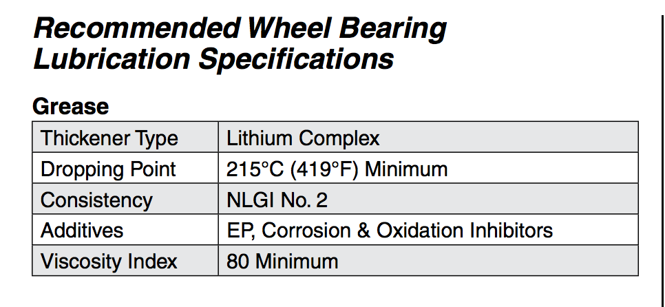

Postby OverTheTopCargoTrailer » Fri Feb 07, 2014 11:42 am
All approved grease for Dexter axels
1 grease.png (70.98 KiB) Viewed 2484 times
2 grease.png (188.92 KiB) Viewed 2484 times
BOB ......... AGAIN I gotta give you 5 STARS for the best answer....
