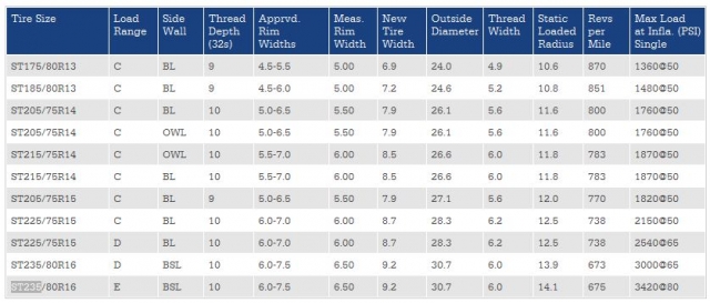

What do they use for tires to get the 5000# rating on a single axle?

Load range E or higher six lug wheels and tires.

MtnDon wrote:What do they use for tires to get the 5000# rating on a single axle?
MtnDon, I sent a request off to the manufacturer. Lets see if they reply early next week.
But I did a little research and this is what I think they will say. They are quoting a 6000# Dexter Torflex axle with 225/75R D tires and electric brakes.
These "D" tires are rated for about 2540 lbs each from what I can see on the web. So taking the weakest link of chain approach, the tires would only support the 5000# rating. Now if E class tires were used at about 2830 # load rating each, that still would not get to the 6000# rating.
Since I am by far no expert in this area, I will stop speculating anymore until I see their reply.
Does this all make sense?

Postby MtnDon » Fri Feb 07, 2014 11:18 pm
Yep. I didn't feel like searching out tire capacities, but I knew my ST205/75R15's would not do the job. :D

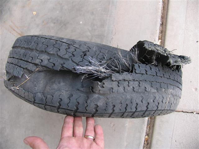

I'd be careful with the tire capacity, 5,000# is pushing it a bit for a single axle as far as tire capacity goes. You'll want to make sure you know what your load really is (get it weighed) and it's loaded evenly. I'm pretty skittish about tire capacity since I had the blow out a couple of years ago, I don't like to run anywhere close to the tire limit...
Goodyear Tire Selector
BTW, I only posted the Marathon tire specs as a reference of typical tire capacity. I won't ever buy another Marathon after two spectacular failures.
P.S. This is what happens to tires when running in hot temperatures at high speed with sketchy capacity:

Postby hankaye » Sat Feb 08, 2014 12:02 pm
bdosborn, Howdy;
Judging from the uneven tread wear I'm thinking that there
was more than a hot tire going on there or the cause of the hot tire.
Do you get your Trailer tires balanced??? Check the hub nuts to be sure
the tires aren't doing any wobbling???
I'm not looking to max. out the weight of my CT when I get it but would like/prefer
the ability to carry what it is that requires the road trip. I'm of the opinion that
80% of max weight is the total I would ever carry so a 4,800# max is more than
enough for me. Closer to 4,000# I would think.
hank
hankaye
Posts: 2567
Location: S.W. New Mexico
Re: 6000# Single Axles
Postby bdosborn » Sat Feb 08, 2014 12:28 pm
The uneven wear was not there when we left the house on our trip:
Tire Failure - Blowout!
Marathons have a reputation for this kind of failure:
Google Marathon Tire Failure
