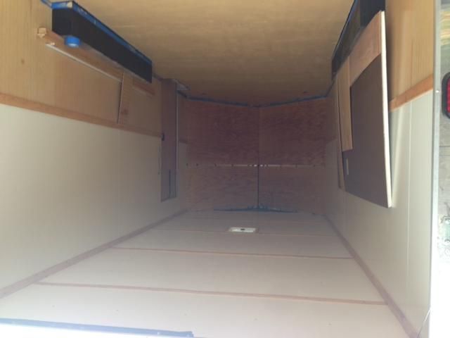

OK, so we get it home....wow, this thing is HUGE. Way bigger than the original 14L x 7W x 6.5H that we started out with in mind. It barely fit in our driveway! So let the build begin! .....So.... a year passes and nothing has happened, everytime we go on fourwheeling trips we stay at cabins or motels so, there hasn't been a real need to get this thing done. And, since my RZR fits in the back of my truck...well, the build just got pushed to the back burner. Finally, last fall I saw another friend who did a conversion and that lit the spark again, so since November 2013 I've been putting time in it here and there. This is our build to date:
This is why I was able to put it off so long.

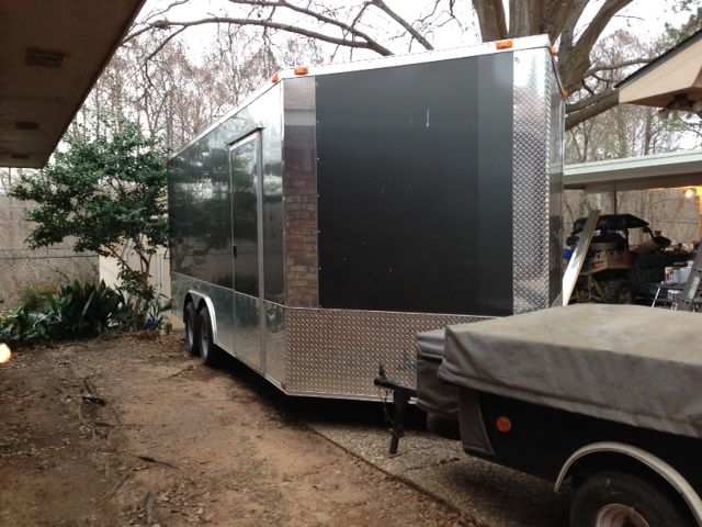

Here it is, hogging up my driveway. BTW, notice the REALLY tiny camper in fron of it, it's a motorcycle popup that we used to pull behind out Goldwing.

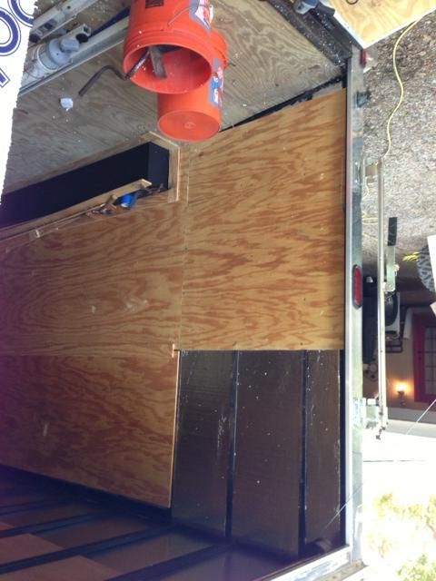

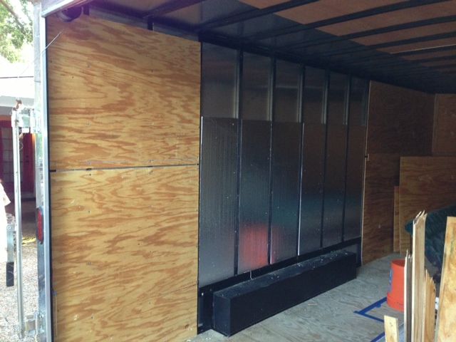

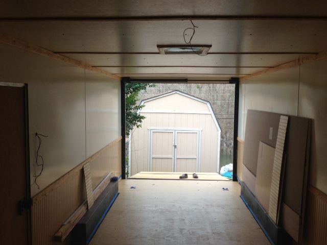

I won't bore you with minor details, there are enough excellent builds threads on TNTTT that cover the details of what I did. One thing that I did do though was to pull down one section of the plywood wall at a time, insulate behind it then put the plywood right back up before going to the next sheet of plywood. I did this because I didn't want to remove ALL of the plywood and the trailer looses some of it's rigidity and possibly flex or bow just enough that the screws wouldn't realign in the holes that they came out of. It worked out for me, I only had to redrill 5-6 holes and that was only because the holes were stripped out.

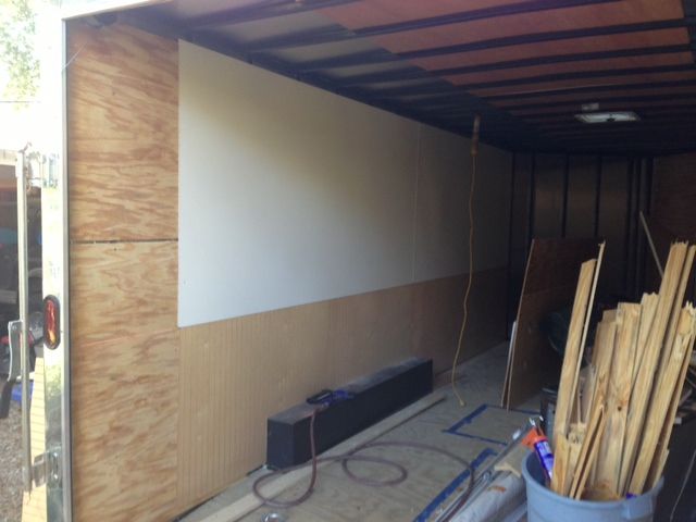

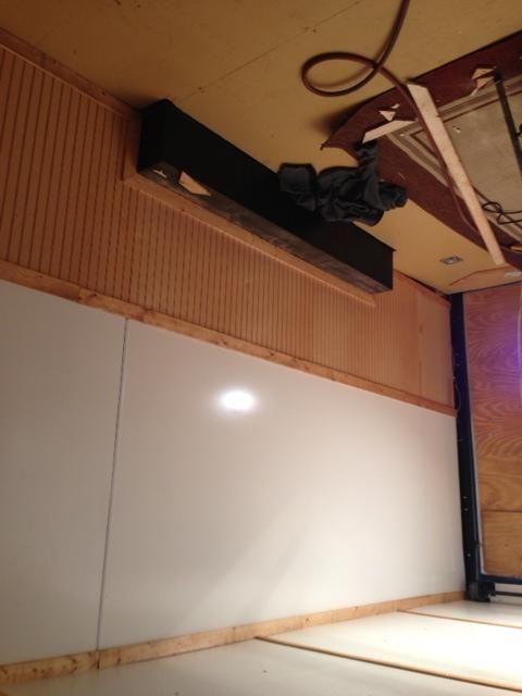

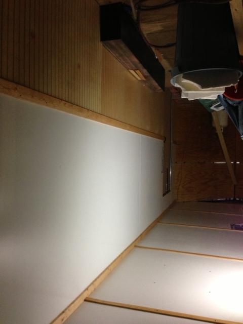

Starting to put up the new interior. That's the 34" X 48" wainscot from Home Depot on the bottom, about $15 each. I think that this is about the most expensive build item so far. The white panel board above the wainscot is about $14 per 4 X 8 sheet, it's only 3/16" thick so it's fairly light weight.

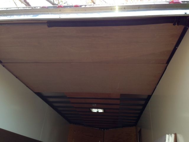

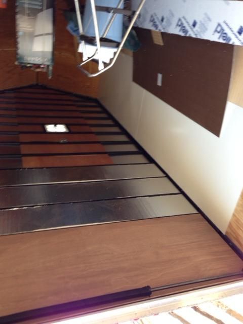

Next is ceiling time! Same 3/4" Styrofoam insulation up top (or is it 1"? I can't remember) for about $15 per 4 X 8 sheet. Cover the insulation up with 1/8" 4 X 8 luan sheets at about $12.50 per sheet.

More ceiling panels up, when all luan panels are up I paint the ceiling white.

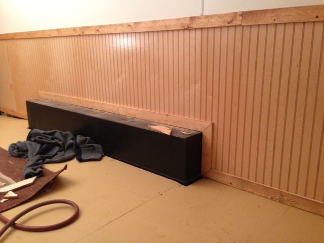

I just used the el cheap-o 1" X 3" pine wood for the trim. I sent it through my planer to take about 1/4" inch off of the thickness. For the ceiling strips I just bought a 2" X 6" and cut it into (just guessing) about 3/16" thick strips. Stained them a light color with Minwax stain/sealer. And screwed the ceiling strips up and brad nailed the other trim.
Rolled on a nice thick couple of coats of brownish/tanish/yellowish deck paint and now I'm ready to finish with the baseboards (same material as the chair rail and crown molding).
Base boards are done. Whew, just in the nick of time. We are leaving next week for a 5 day ride up into the Ozark mountains. BIG RZR rally up there and guess what, all cabins were booked. Gotta camp or drive 25 miles one way back into town to stay in a motel room.... We'll be camping!

Postby Banjo » Thu Mar 06, 2014 9:26 am
You are going to have a great build there when finished . I will be starting my second 6x12 build this summer . I also want wainscot and have checked Home Depot and Lowes , but have only seen it made from birch on a wood backing , 3/16 I believe for 38 /39 $ for 4x8 sheet . Lowes had a finish on it for 39$ . How did you find it for 15$ ,is it a plYwood backing or not ? I think I may have seen some finished in white and was not a ply backing .

Banjo, That's the stuff. They just cut it into thirds (32", not the 34" that I said in my post) and get $15 per 1/3 sheets. I could've saved a couple bucks by buying the 4' X 8' sheets of the birch wainscot but I figured it's be a lot easier to handle if they were pre cut. This stuff had a finish already on it. I think they also had it in white.
