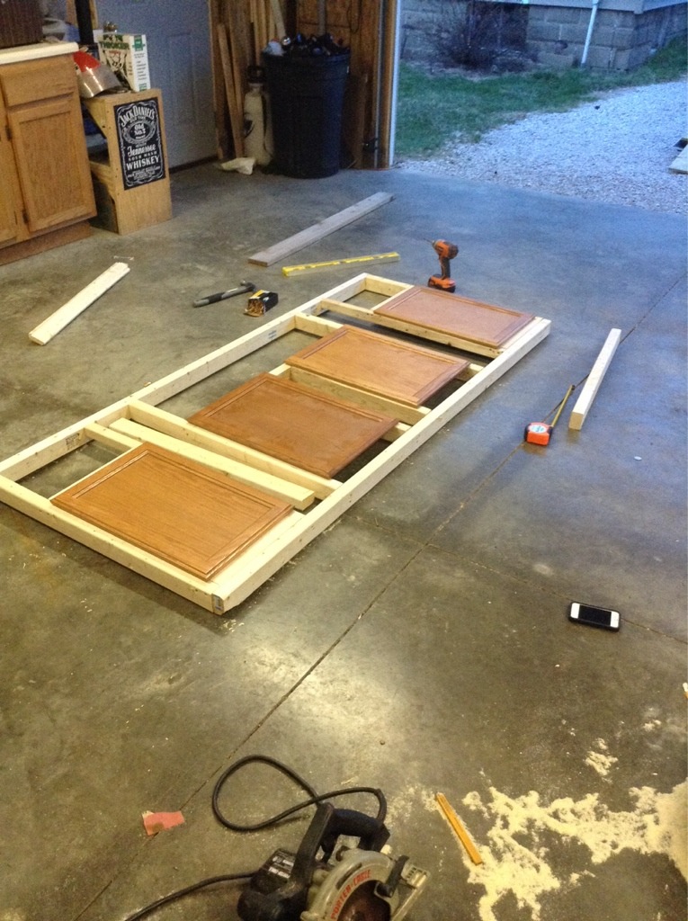

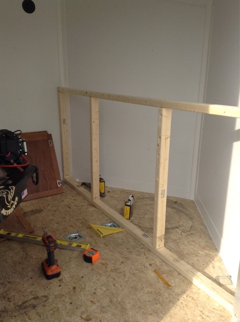

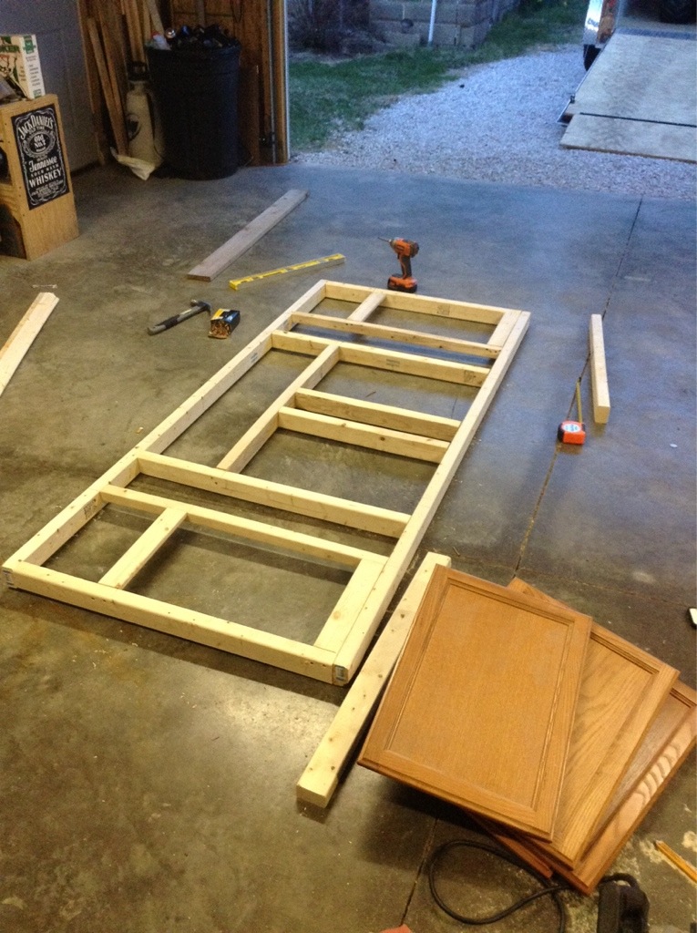

Thanks for the tip! I've figured out tonight, that I am a horrible carpenter....didn't really help using junk wood from menards. Ended up using mainly 2x3's. Here's what I have so far, started off by building the basic frame in the trailer, with ATV in there just to visualize the space. I then took it out and finished the framing in the garage. I'm hoping tomorrow, to put it back in and start tying it into the trailer for permanent mounting. I went to a builder supply today and found four matching cabinet doors for $24! They weren't as tall as I hoped, but they'll work. The boxes in the upper corners of the frame I built, will be for the speakers, and the center area will probably be half used for stereo head unit, and the other half be open shelving for "charging station" for phones.

Postby AZ_Desert_Rat » Sun Apr 13, 2014 2:09 pm
Hi Mike,
It looks like you are off to a great start. :applause:
Don't worry about the carpenter skills; a great thing about building your own projects is that you can change the plans and modify as YOU PLEASE AND it all comes out in the wash. If you build something and are not satisfied, leave it in or take it out and build it again ... it is all good. :D
I have several panels I changed out and am still waiting to build the overhead for the galley. :roll:
The frame looks great and we are waiting to see it finished. :applause: :applause:

Re: Tips for a newbie build please?
Postby AZ_Desert_Rat » Sun Apr 13, 2014 2:18 pm
Hey Mike,
Just curious, are you going to face the frame with plywood or ??? If you do that before you install the doors, you should be able to correct the height issue (bottom or top) with a wood strip (same thickness or less than frame size), depending on your taste and then, use a router with a flush-trim bit to make the door opening the same as the frame opening ... Just thinking out loud :roll:
