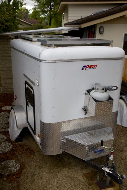

Postby astrotrailer » Fri Jun 20, 2014 11:49 am
Sorry, here are a couple of links and a picture for those not wanted to search for posting under my username.
The inside layout is to allow us to bring as much astronomy gear as possible which stays outside once we get to the destination. The ramp door facilities rolling in heavy equipment such as a 110 pound 20 inch Dobsonian telescope. We put up a popup sun shelter in the warmer months for shade outside. We cook, eat and socialize outside under the popup shelter. The trailer is a place for sleeping, using the laptop inside at the desk out of the sunshine when image processing in the daytime and a warming room on cold nights of astronomy. The use of plastic crates with lids helps with the packing and keeps things dry when stored outside if the weather changes to rainy. Fortunately when don't do astronomy where is rains or is cloudy very often.
I moved the spare tire to the back of the ramp door to make room for my propane bottle when I added the furnace. I use the propane in the daytime to feed a outdoor grill and two burner stove that sits on a table next to the trailer. I reconnect the furnace connection after dinner if it is going to be cold overnight. We use a 3 inch roll up memory foam topper on top of a 4 inch fold up mattress that goes on the padded carpet floor. All items go up on shelves when its time to put out the bed. There are storage shelves to hold the bedding during the daytime. Sleeping setup is cozy but works well for my wife and I and is much better for sleeping in under full summer sun after going to bed at 4AM.
I take pictures of astronomical objects when camping. I set up my telescope imaging mounts and cameras about 20 feet from the trailer. I found the voltage drop over the original 14 gauge wire was a bit too much. I built a 4 gauge 25 foot wire assembly that goes directly off of fuse protect power pole connector inside my battery box. I have a breakout 12 volt distribution system at the other end of the cable for my mount, cameras laptop and other 12 volt items used for astronomy. My power is now very reliable for my astronomy needs.
We don't have any plumbing other than propane in the trailer. This is so we either camp at astronomy events that have facilities available or are camping on BLM land in very rural Nevada where a shovel meets the need. As backpackers we are used to cat holes. We make use of the 240 watts of solar power in the daytime to recharge the 220 amp-hour batteries, run a sine wave inverter to power the blender or vacuum cleaner, power laptops, recharge tablets, phones, Engel Freezer, personal evaporate cooler and other stuff. I have a DC-DC smart charger for recharging smaller stand-alone 3, 7, 12 or 35 amp-hour batteries used for astronomy stuff that isn't part of my imaging setup.

Postby Rainier70 » Fri Jun 20, 2014 2:11 pm
I don't think I saw before how you mounted your propane tank. Very nice solution.
