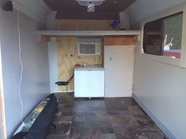

It's pretty basic. So far I've insulated the walls floor and ceiling with
1" thick foil sided sheets. Put down vinyl on the floor and luan on the
ceiling and walls. I've also installed a small window ac and a roof vent.
Put in a fridge and I'm working on a loft bed for my son. Also have 12v
LEDs and sockets with a small solar charger and a optima blue top battery.
This project would have cost me more but I already had the battery and
the insulation. I'll get more pics when I'm done. Hopefully in about a week.

Postby printer88 » Sun Jul 06, 2014 6:01 pm
Finally got a pic of the inside. Still need some paint and some bedding but getting there :)Image
