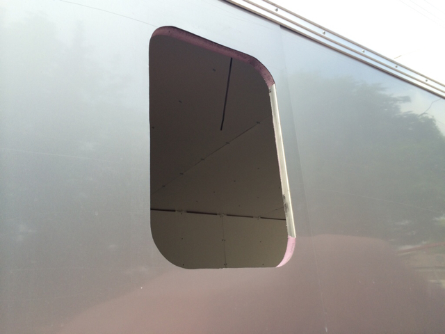

Tried searching can't find an answer. I just got my windows and installed the first one last night. I took a lot of time as this was the first hole I cut into my new trailer.
My windows are 14" x 21" to fit between the studs. I have 4 of them for my 7x16 vnose.
I have a couple of questions, first is it ok to just attach them with the metal screws that go through the trim ring and then into the back side of the window frame? Do I need to drill all the way through the frame so that they are mounted with a bolt that goes all the way trough the frame and trim ring? I don't want the to work their way loose and fall out if the threads stripe.
Second, on the door side, would you suggest putting a window in the door or in the side next to the door?
Lastly the windows came with a rubber seal attached. Is this sufficient or do I need to use some silicone sealant?
Thanks
Jeff

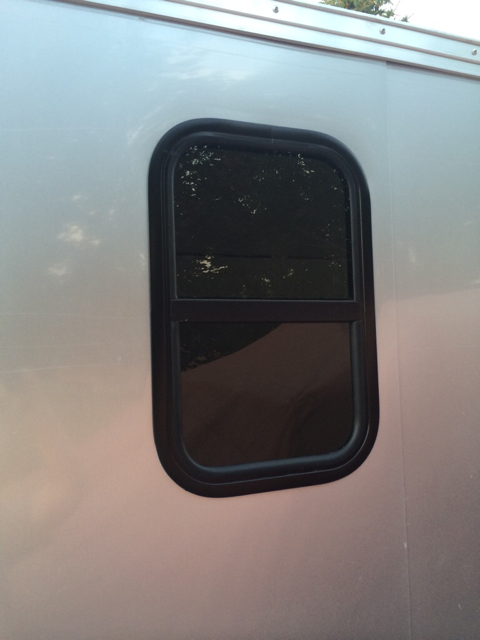

I got 3 of the windows in and installed a roof vent, fantastic fan. I had the same thoughts on someone breaking a window and opening the door. I was told if someone wants in they are getting in. So not sure what I want to do. That's way I held off on putting in the 4th window until I decide.
