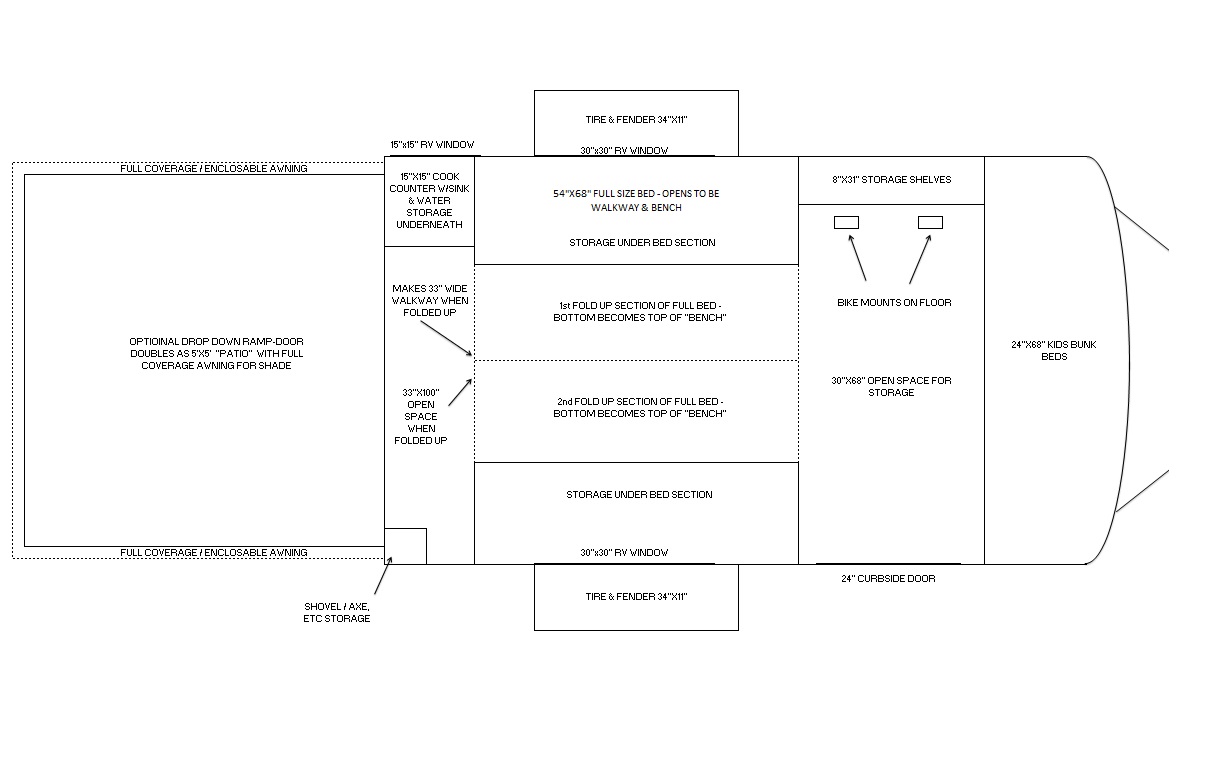

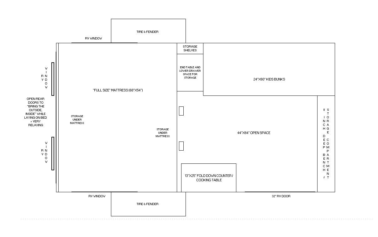

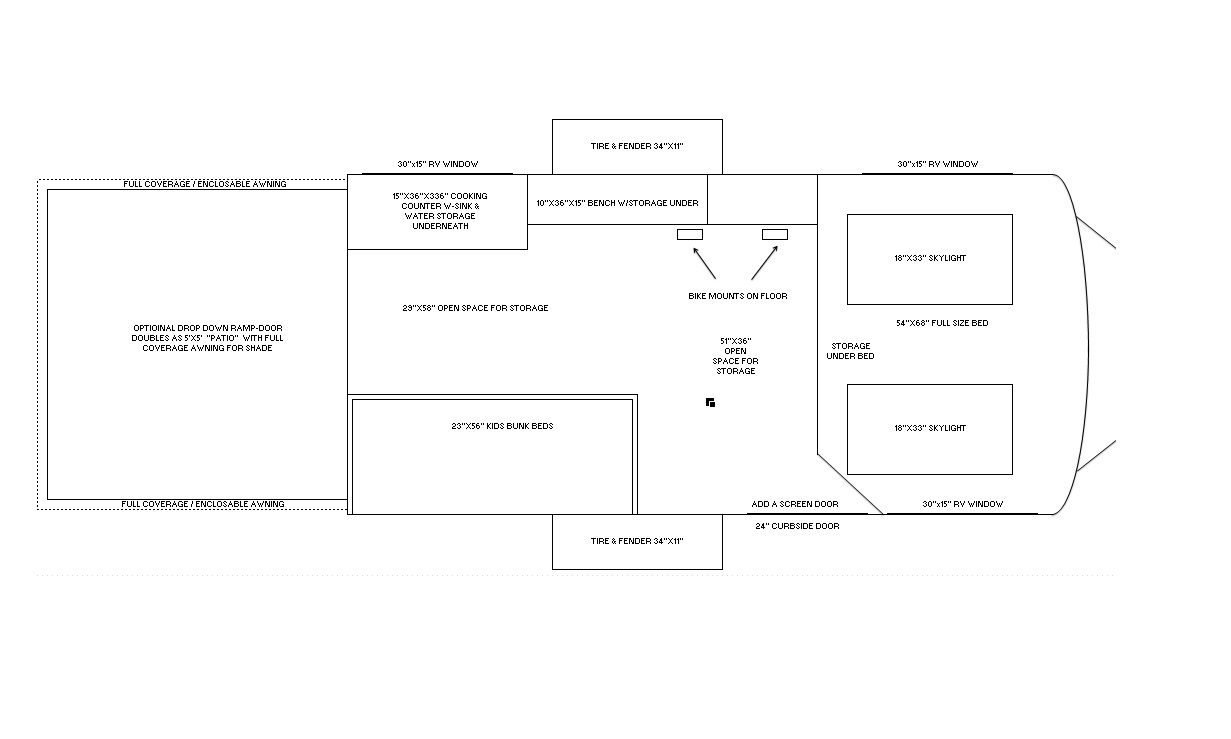

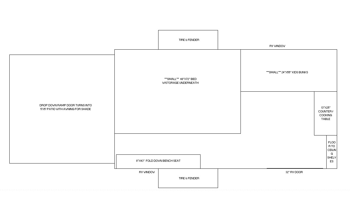

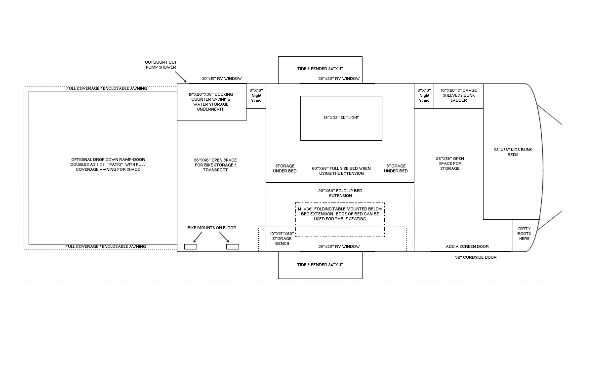

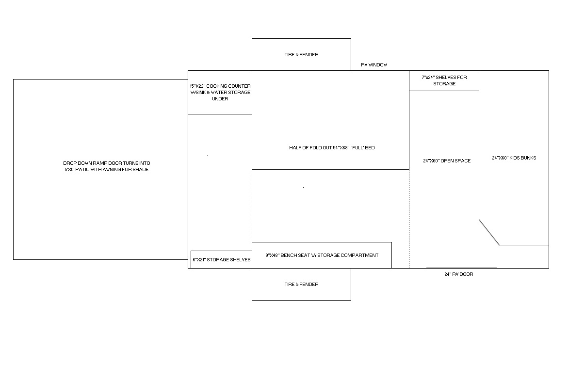

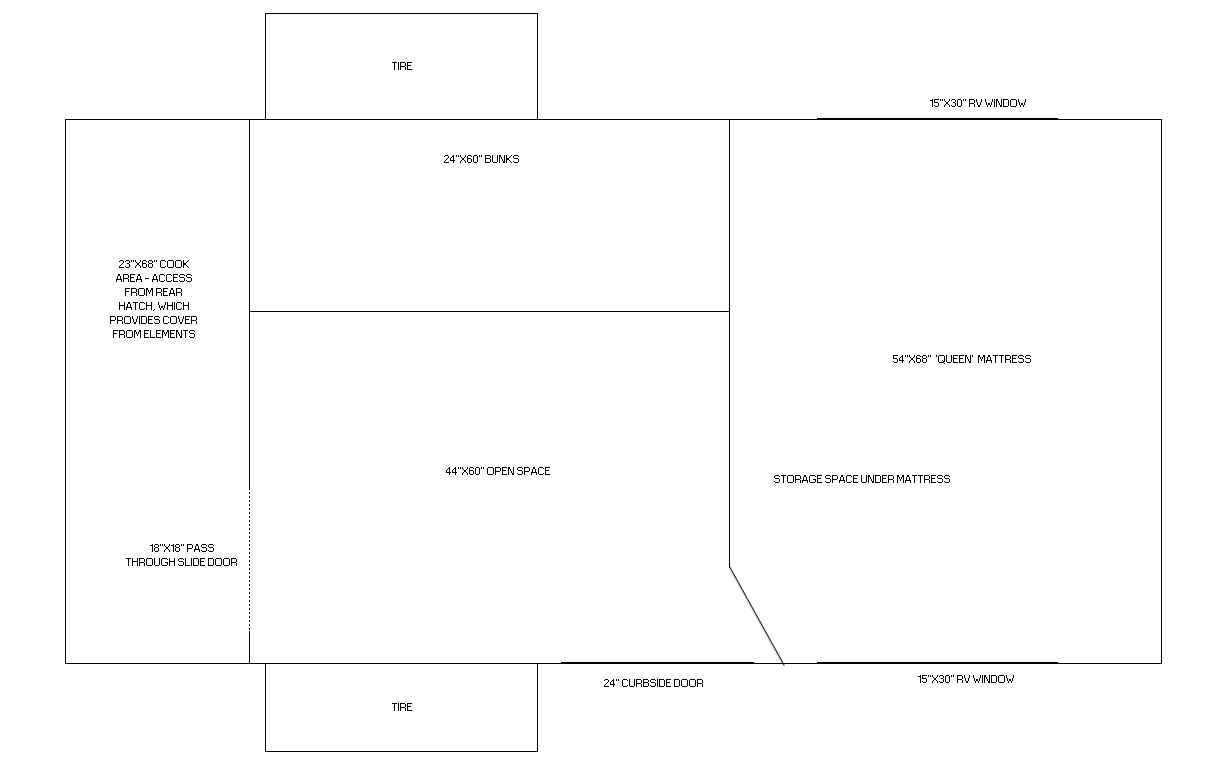

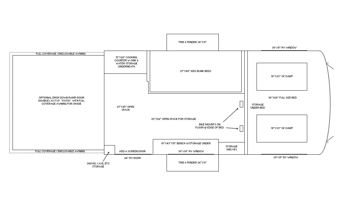

Postby Backwoods Rambler » Fri Aug 01, 2014 4:33 pm
Here are jpegs of the floor plans I drew up. Dimensions are there, and they're as close to scale as I can make them using MS Excel as "graph paper". 8)
CTC 6X10 - Floor Plan 4 - Top View.jpg (55.91 KiB) Viewed 2466 times

Postby Backwoods Rambler » Fri Aug 01, 2014 4:36 pm
Those were all 6x10 floor plans. Here are a couple of 6x12's...

Postby Backwoods Rambler » Fri Aug 01, 2014 4:39 pm
My favorite floor plans require a custom trailer side door placement, which means a new trailer assuming most don't have the skills to relocate a side door. Also, I think a 32" wide side door is overkill so several of my plan spec a 24" side door. On the other hand a few of my floor plans work around all of the specs you'd find in a typical "off the lot" or used trailer.
Good luck with your decision
