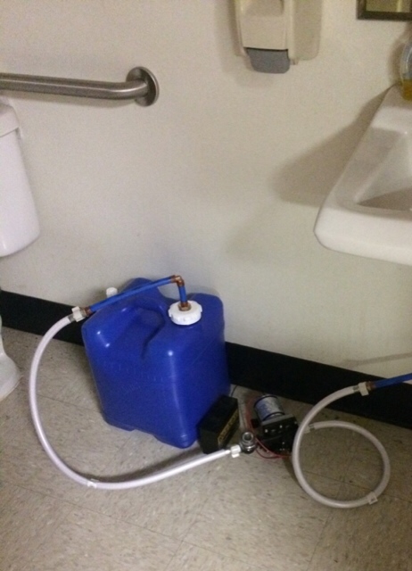

Two 7 gallon aquatainers, a $50 Shurflo and some pex is about the same price and easier to handle.

Postby abqlloyd » Sun Aug 17, 2014 9:57 pm
We've used this system in portable building when running water is mandated. Battery is 12AH I think. Simple switch and some pex.
Fittings are 3/4"MPT on the water container for the pickup tube. Lay it flat and skip the pickup tube. The extra spigot is $5 on amazon. When the water runs low just change the tank.
