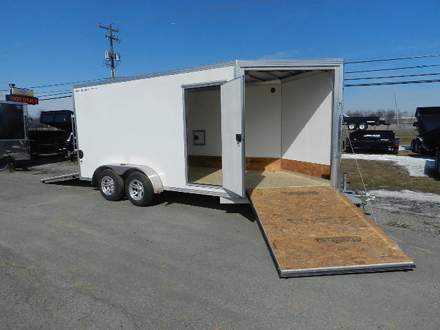

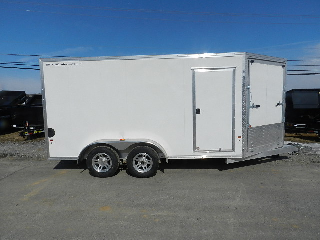

Hi all we picked up a 7x14 aluminum snow mobile trailer a few months back for moving stuff (military so we move a bunch) with a secondary plan of making a camper out of it. Empty weight is around 1.5K, and we maxed its (and our jeeps) GVWR on our move and it handled great, though getting the weight distribution hitch set up with the deep vee-nose took some time. We are living in New Orleans now, so number one item on the list is insulation and A/C if we hope to get any summer use out of it.
Idea/Question #1.- I'm thinking of trying to either do a canopy (ala coleman pop-up) or a rigid/foldable foam-ply structure (4-piece, a knee wall, 2 sides and a slant roof) to enclose the the ramps as beds. I have seen a few pictures on the net, but wasn't sure if anyone had attempted anything similar here. The ramp sizes will fit a queen in the back and a twin up front based on my measurements, and doing so gives me a ton more options on the interior.

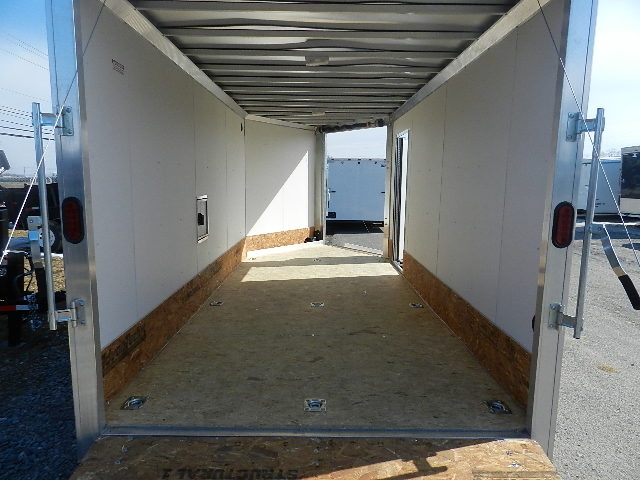

#2-insulation, its all aluminum and I plan to look into quotes on spray foaming the interior and underside, but was curious what everyone's recommendations on insulation are. I'm a mech. engineer so I have a sound knowledge on thermo-dynamics and don't care to add a ton of extra layers to achieve a true thermal break (the ramp idea kills most of the isolation anyway) hence leaning toward having it sprayed. Not sure what the cost will be on that (anyone have experience there?) That said I'm also happy to just use a bigger furnace and air conditioner for the few occasions we'll need it. How has the single foam layers worked for you all? Any reason to use white vs pink style foam? I thought I saw over the top use denim insulation, any benefit on that over a rigid foam? I have extra head-room (6'6" or so) so I'll likely be dual layering the top regardless of the type of insulation I use.
#3-Fantastic vents- I hear nothing but praise about them. We have a seamless roof, I'd prefer to keep it that way. Just how good are they? Is it worth cutting into the roof for that & 2 anyone have experience with side mounting them?

This is similar to what I'm thinking on the ramp doors....
http://www.starling-travel.com/2013/02/ ... ification/
I'll need to play with the dimensions to see if I can get them to collapse into the dimensions of the ramp itself, but think it should be easily doable. Figuring out the hinge orientation and the flashing to keep it tight is going to be a little more difficult.

...Example with a canvas foldout... So it's definitely doable. Still think the hard sides will be better in the long run. Though we'll see which will be cheaper and easier to make.

I used the foil sided white insulation inside, and pink underneath. The pink and blue insulation boards have a slightly higher r value. They also don't absorb any moisture. If you live in a humid climate, I would stay away from any insulation that will absorb moisture such as denim.

If you are still going to use the trailer for cargo, maybe you should consider having the bedroom "hard" roof sections hinged at the top of the ramp door openings, with the end walls hinged to them. This way they can be lifted up out of the way when you want to use the ramps. That way they do not have to be as robust to handle loading traffic, as they would if they folded down onto the ramp doors. This would also give the option of having them be just canopies without folding the side walls down.

As far as the build goes. I opted for rigid poly insulation boards due to cost after getting a few spray quotes, including pricing the DIY kits. Ripping them on the table saw makes quick work for sizing them. After trying a few adhesives I'm sticking with knocked down great stuff spray cans. I have 2 layers of half inch between the studs, and I'll put a final layer across the top for the sides. I haven't looked at the ceiling yet to decide. The battery is in, barely fit with the box under the frame but it worked out. New jack is on, allowing the large propane tank up front, and I'm slowing going through insulating and starting to wire everything up.
I have one side of the trailer insulated at this point and prepping to put in a fantastic vent which recently showed up in the mail. My original intention was to mount it vertically on the drivers side of the trailer just aft of the V. After receiving the vent I realized the left side of the vent is the side the opening arm is, which is much stiffer. The right side, which would face forward if mounted on the drivers side is unsupported and flexes abit.
I'm not worried about water intrusion with the vertical mount; between the existing gasket, and a homemade gutter/sill it'll be fine. But I am reconsidering putting it on the drivers side because of the flex of the dome. I could see the wind possibly catching/pulling at it while going down the interstate. Installing it on the passenger side of the trailer puts the opening arm forward, and would alleviate the concern.

Check out how they are installed on regular RVs. That's how they are designed.
