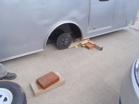

My CT, when it arrives, will be too tall to get into my garage which has a 96 inch garage door height. During the colder months of this winter, I want to bring it inside to work on it. I am looking for ideas on how to do it. One is to make small steel discs to use as wheels as one other poster did. And this make be my best option.

I've seen people use smaller diameter wheels with the same lug bolt pattern. I believe it was in the TnTT forums somewhere. Try a Search.

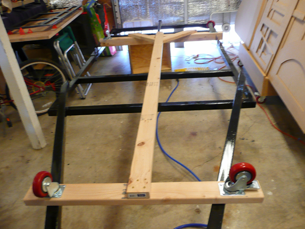

I made a dolly for my teardrop, not for height reasons, but for maneuverability, because of the limited space in my garage. Here's a (fuzzy) picture of it before flipping it over.
I used 500# swivel casters at all four corners. If you go this route, I'd add a middle pair for better weight distribution.
