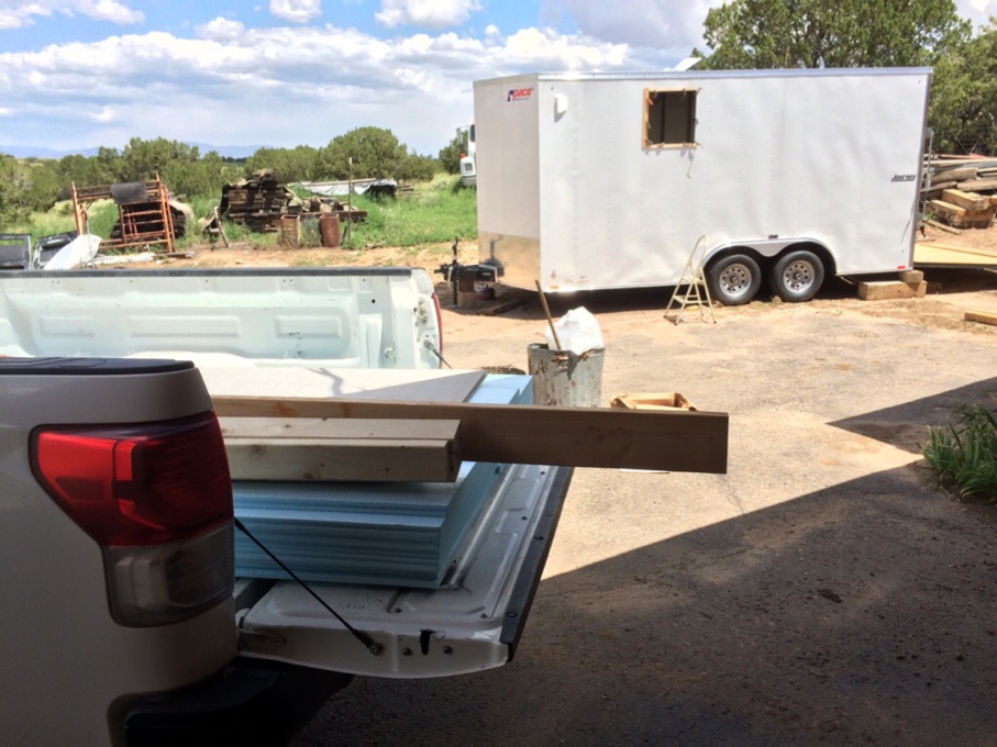

Picked up my cargo trailer a couple months back.
Been busting serious ass working on it since august. Have to drive it up to Oregon at the end of September where I won't have much shop space to work on it.
First stop after pick up, buena vista Co to camp a night with a friend. Breaking her in real nice ha
Started ripping the walls down and picked up a cast iron wood stove for my heat source

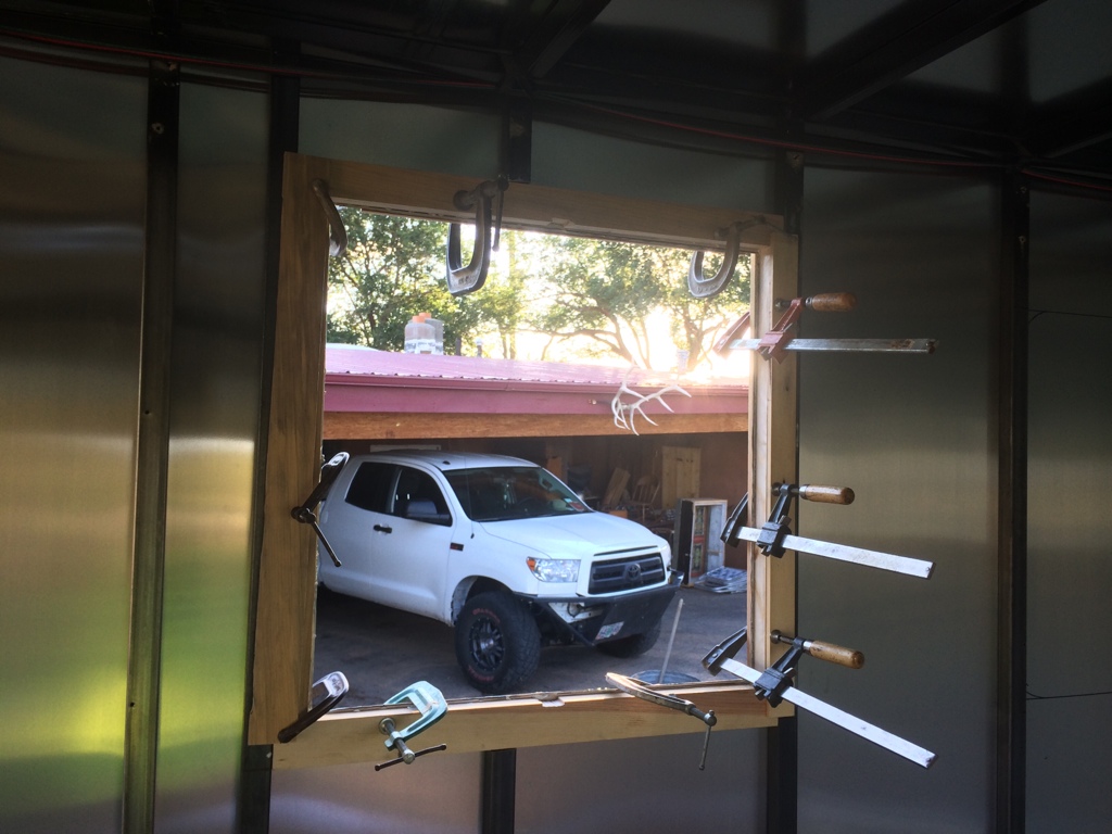

Framed in window #1 24x24 on the driver size

Love the Tundra! What are your plans for the trailer?

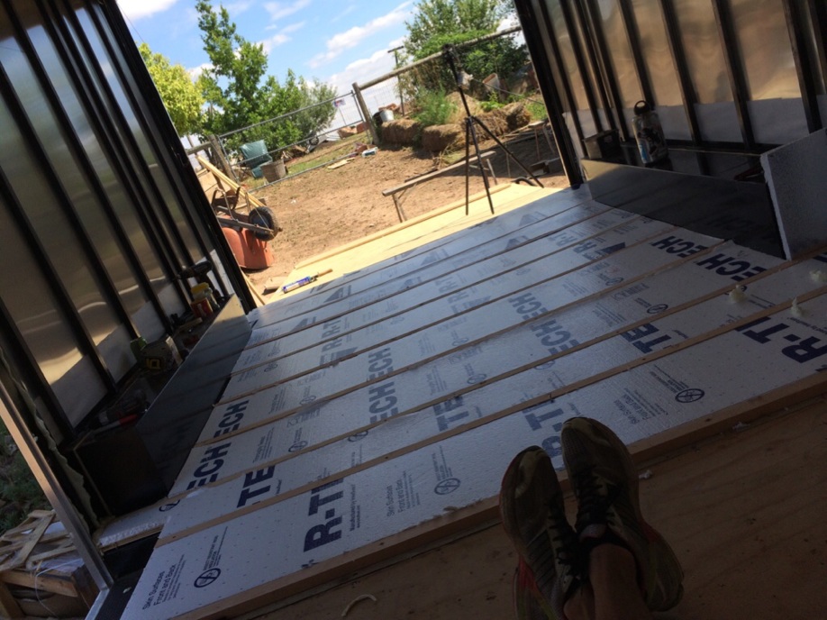

Buying lots of insulation. Put an inch of expanded foam on the floor. And two inches of rigid on the walls. That should give me roughly, R~3 and R10 on the walls.
Also got in a second window on the driver side. 24x36

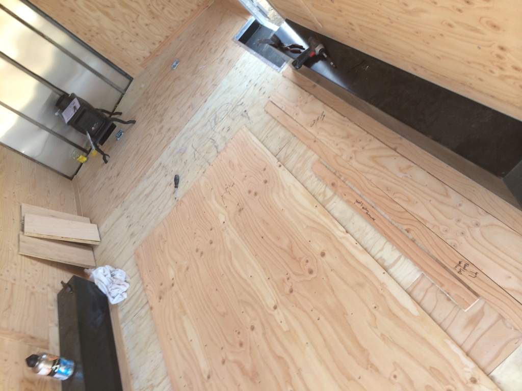

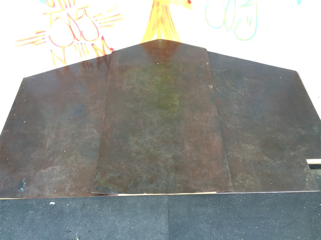

For the flooring I put down 3/4 inch horse mat that thick rubber sh**. Will help reduce heat transfer I imagine. That just in the rear 13-14 ft of the trailer. In the front where the stove goes I but 3/4 in ply above the insulation. Then 3 sheets of 1/16 in restored and blackened (the gun blue chem) steel. It was very rusted before hand. The stove is waiting for it's final fastening plans. I thinking a steel strap over the top secured to the original floor anchors. But I think a bolt from top down through the existing feet will be the best... Hmm
The front wall, behind the stove, I've fastened 1/4in hardibacker I will add hat channel and rivet corrugated steel that will serve as a heat shield in front of the hardibacker and insulation. The corrugated will not be sealed so it will allow for that convection.

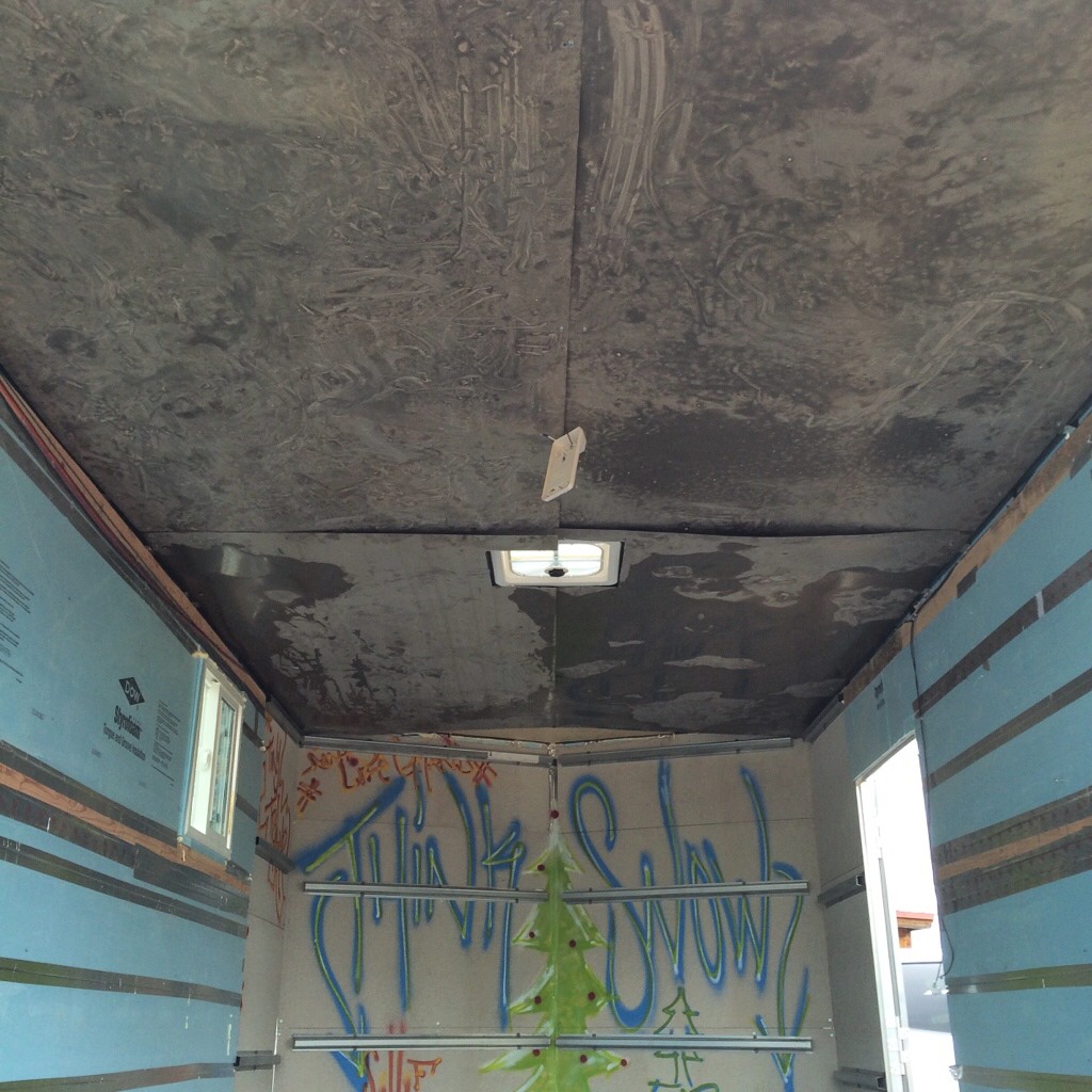

I'm putting up 26 gauge bonded steel sheet over the 1" of insulation in the ceiling this part of it was a real pain in the arse
