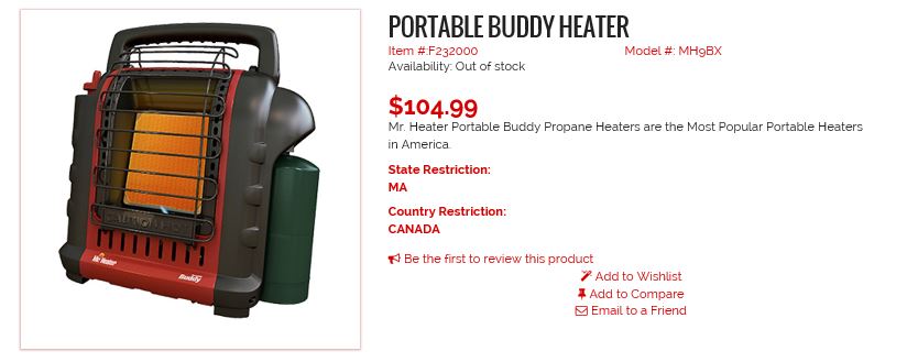

Mr Heater Buddy 4,000-9,000-BTU Indoor-Safe Portable Radiant Heater
I have the large version, the "Big Buddy" for emergency and backup heat - complete overkill for a trailer although you can run it all the way down to the same 4K BTU
I know the Big Buddy can be adapted to a grill/RV tank in addition to its native bottles. Not sure about the regular Buddy.
It's my understanding you can't drop down to the Little Buddy because that one is NOT indoor safe.

If you read the warning tag on the buddy heater I thing you will find ( provide ventilation ) I would never trust the safeties on a un-venter heater when sleeping.Most safety's is a thermocouple a little bit from the flame. when their is a low oxygen the flame will not heat the therocouple and it will shut off ,one hopes!! You may be sleeping forever. Ask any DNR officer about un-venter heaters in fish houses. Not good!! Plus a unvented heater puts lots of water in the air.
Just my opinion. Be safe.

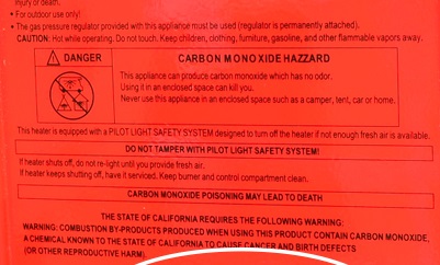

Postby working on it » Sun Sep 14, 2014 8:48 pm
khigh wrote:Mr Heater Buddy 4,000-9,000-BTU Indoor-Safe Portable Radiant Heater
When I was researching heaters for my 4x8 trailer, I looked at the same model you show, but the warning on the backside scared me off
f232000 backside warning.jpg (62.42 KiB) Viewed 3410 times
I got this photo straight from their website, when I just now tried to pull up the manual
Went the other direction, to electric. I ended up getting a Lasko My Heat, which only draws 200 watts, and can heat up my 4x8 in a hurry. I've also used it inside my HHR Panel, when I spend the night at work (when ice storms prevent my 120 mile round-trip). Keeps me warm down to 8 degrees (lowest temp seen).

Postby warnmar10 » Sun Sep 14, 2014 10:48 pm
working on it wrote:When I was researching heaters for my 4x8 trailer, I looked at the same model you show, but the warning on the backside scared me off
From the Mr Buddy instruction manual, emphasis mine:
General Information:
• This heater is safe for indoor use in small recreational
enclosures having means for providing combustion air
and ventilation
, such as enclosed porches, cabins, fishing
huts, trailers, tent trailers, tents, truck caps and vans.
It may be used for emergency indoor heating when
connected to a disposable 1-lb. propane cylinder and
for indoor use in commercial enclosures, having means
for providing combustion air and ventilation, such as
construction trailers or temporary work enclosures
http://www.campingworld.com/includes/pr ... manual.pdf
I recommend anyone considering using a gas fired space heater in an enclosed space do your own research and take the added precaution of installing a CO detector. Having said that, the 4k/9k Mr Buddy requires 4 square inches of combustion air opening to provide adequate combustion and makeup air.
Maybe because I was born and raised in a house heated by nothing but natural gas fired space heaters I'm not afraid of them. I do recognize the need for a fresh air supply. In a drafty old house that isn't a big concern. In a mostly air-tight tiny trailer it is a huge concern. But a window, or two, cracked open and respect for clearances and I've slept just fine in my trailer or my deer blind... or my parents' old drafty house.
Begin Flames in 5, 4, 3, 2
