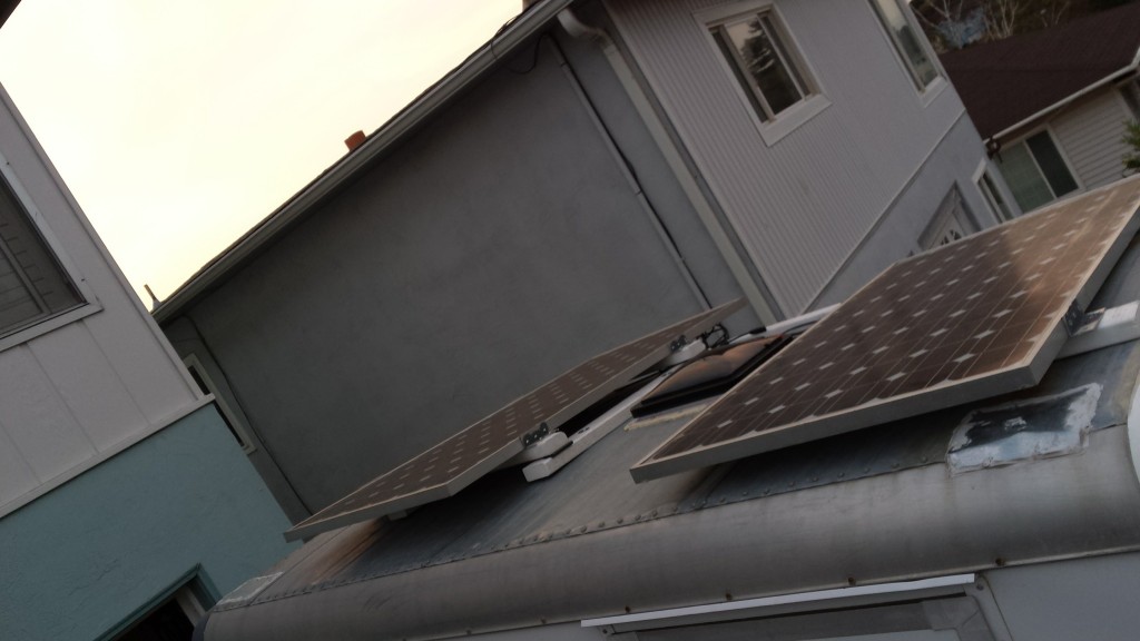

Nice. How did you mount the solar panels? I have some Z-mounts I was thinking of using.
abqlloyd
Posts: 273
Joined: Mon Aug 08, 2005 11:47 pm
Re: vaxRV 2.0 cargo trailer toy hauler conversion
Postby vax » Sun Sep 14, 2014 7:01 pm
I used 1/4in bolts. drilled through the internal steel frame to secure it, then attached 2x4s up top and lag bolted aluminum angle brackets. here are some pics and a brief write up http://vaxrv.com/2014/09/solar-panels/Image

That's a lot of batteries for 200 watts in panels.
OTTCT
http://overthetopcargotrailer.blogspot.com/
OverTheTopCargoTrailer
Posts: 1628
Postby vax » Mon Sep 15, 2014 1:09 pm
350watts in panels. 450 amp hours in batts yea its over kill, I need more roof!

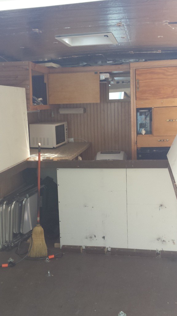

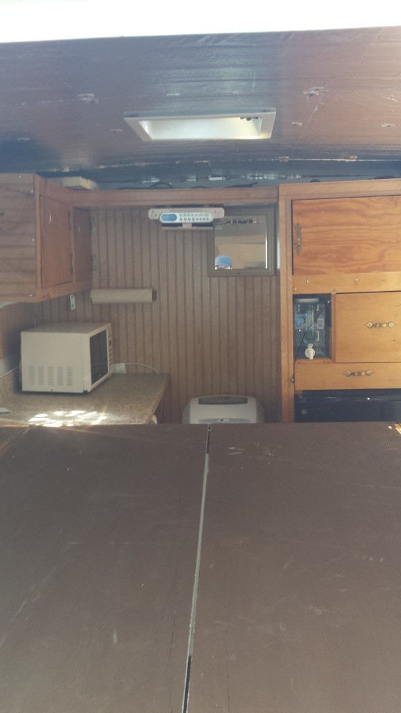

Postby Rchr » Sun Oct 12, 2014 1:07 pm
Greetings, I see you used a portable A/C, how has it worked out for you?

Postby vax » Mon Nov 16, 2015 4:15 pm
thanks for the tips, thats good to know. Yes its a portable AC unit, 9000 btu's. It works decently but as far as I can tell a window unit would be better suited and more efficient. if I could redo it I would have built a 5000 btu window unit in and duct it accordingly. I run a generator if I'm running AC which is the only downside, while the inverter will crank it, I know that it'll completely drain my bank in no time so I avoid using it for that. I have an efficient yamaha gennie that runs it great. I've tested it in desert trips with no real issues, naturally when I open the trailer I lose my cold so that sucks but thats normal. if temps climb too high it will kind of crap out, the inside insulation helps a ton though, I dont need AC in the desert til almost noon and it keeps a decent temp unless I let the heat in.
