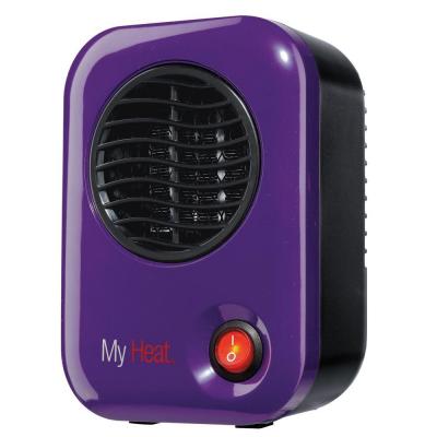

Postby working on it » Tue Sep 16, 2014 10:09 pm
bdosborn wrote:Image
Broan-NuTone (6201) Big Heat Heater
Kind of expensive but you only have to buy one. The $20 jobs don't seem to last longer than a season or two...
Granted, the $20 heaters don't last long, and most don't have adjustable thermostats, but the deciding factor in choosing to get a Lasko 200 Watt Ceramic Heater
Lasko My Heat 200 Watt.jpg (14.81 KiB) Viewed 1723 times
was the low amperage draw (2 amps @120vac). I only have an around 80-85 cubic feet space to heat, and the Lasko is advertised to heat 300 c.f. (should be closer to 262, as calculated, so it is quite sufficient), and if the 120vac power fails, my 12vdc battery could power it thru the 410 watt inverter. If used judiciously! I don't see that I'll need to run it for long, as I'm in Texas, and a fair-weather camper (so far), so it is enough. I tested a couple of adjustable thermo types, but even set as low as I could set them, they tripped off the inverter (which is the last resort test). Of course, I wouldn't want to drain my battery that way, unless a short spurt of heat was all-important (ward off hypothermia?); I have multiple comforters and a zero degree sleeping bag for my winter usage, as a rule, from experiences many years ago. That's the plan for my forseeable needs: a larger, cargo conversion would need more heating capacity, but carrying along a low-powered "last resort" heater might not be inadvisable, just in case.
