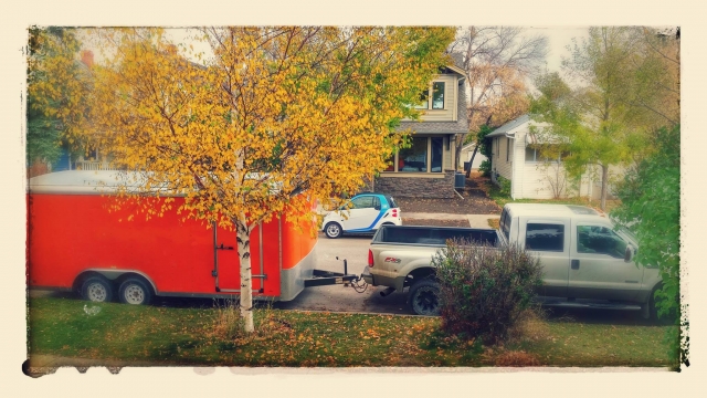

After over 2 years of window shopping, planning, rethinking, false starts, big dreams, reality checks etc....
I finally bought a trailer:
Considering my northern location I figure this unit will be too small for full time living including plumbing, so I'm considering this a starter unit, for use until I get my real project going.
At some point I'll have a much larger trailer with every creature comfort I desire, but for now this is what I have to work with so the list will start with essentials and end before it becomes claustrophobic.
Since we're on the threshold of winter I'll be shortcutting some things (ie. the ramp / porch ) in favor of getting it livable asap.
This should be a fun project for me, and anyone who takes an interest in following it, as it will be a learning experience and very much an experiment. Any wrong turns could require fixing in the middle of a dark and windy minus 53 C night.
Tow vehcicle: 2007 F350, crew cab, diesel, dually, long box.
Trailer: 2008 8.5x18 cargo trailer with ramp door (no idea on the make, just says Owens Cargo Inc on some stickers, assume they assembled it)
Dependants who didn't qualify as tax deductions: Bella and Nina, my dogs.

Could be difficult to stealth camp in this thing, the color doesn't blend with anything.
dustboy wrote:You should be able to make a comfy little house out of that! Although with all the insulation you'll need you might not have much space left!
The insulation was the reason behind going with max width, space disappears quick.

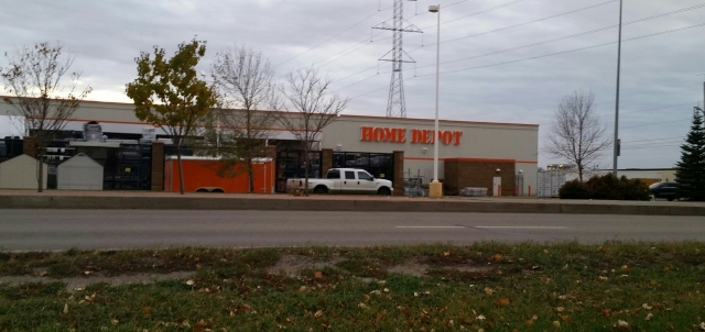

Looks like stealth camping at Home Depot loading dock should be no problem
I suspect (or hope) that as we were trying to point out the air quality issues his trailer would face, that he would be able to discover the source of his homes air issue. Either that or he tried using his cars engine exhaust as a warm air source. Hope he's ok.

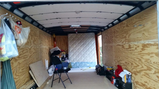

Postby Chilly Willy » Thu Oct 23, 2014 2:22 pm
Bunch done, and a bunch of pictures, but was having a heck of a time figuring out how to reduce the 5mb photos my phone takes to a more sensible size... just discovered that texting them to myself does the trick.

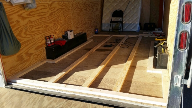

the floor

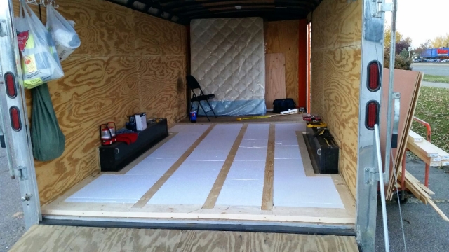

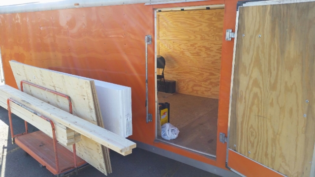

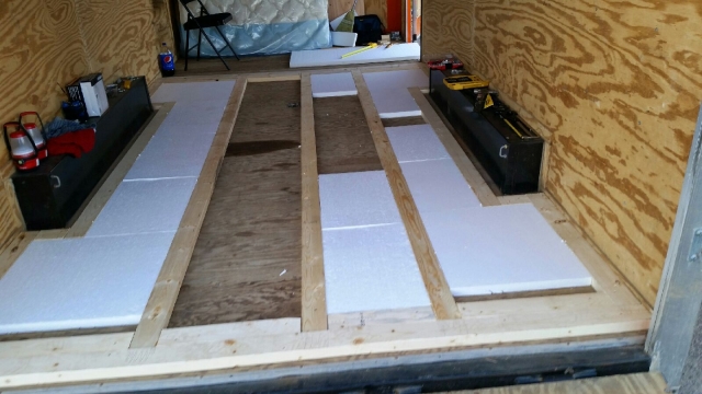

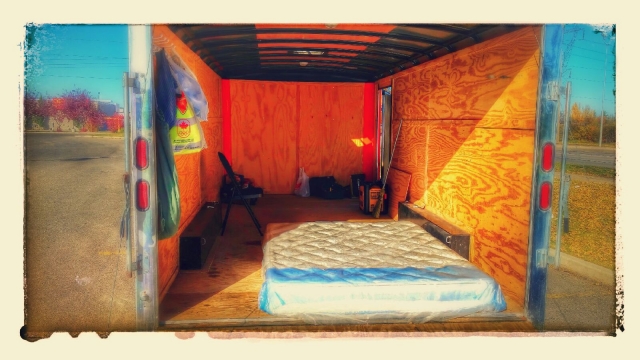

Postby Chilly Willy » Thu Oct 23, 2014 3:31 pm
I've decided to build a 12' insulated bedroom at the back of the trailer, which leaves me with a roughly 5' coldroom at the front. Coldroom will also be insulated, but will only get its heat from leeching the bedroom. Going to arrange fresh air access from outside to the coldroom, then to the bedroom. Hoping that in theory if the outside air hits minus 50C, and the bedroom is at 15C, that the coldroom ends up somewhere between minus 10 and plus 10. This will create a lobby so that I dont lose all my warm air every time I open the door. Also if I put my in use propane bottle inside it won't get so cold that it ceases to function.

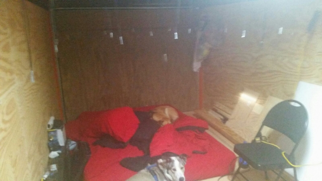

Here are my supervisors.
Did I mention this is a living project? As in I'll be living in it as I build it.
Every time I do major work all my stuff needs to get put into the truck. Between that and the amount of walking my dogs need every stage has as much overhead as Tuts burial plot.

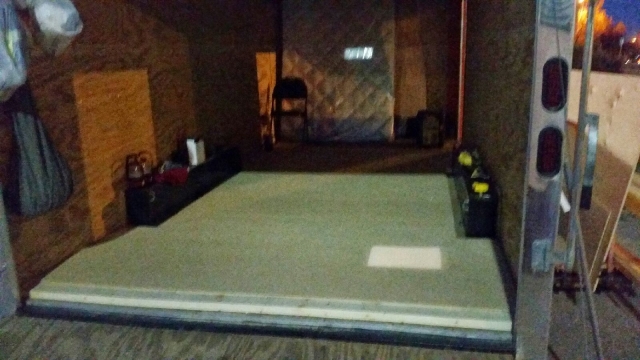

My new floor arrives, some assembly required.
Throwing down some lumber with just enough screws to keep it from moving. Trying to keep the dismantle process as easy as possible.
Done and dark. Had to hurry since I cant exactly load my stuff and dogs onto styrofoam.
After walking on this for a couple days I decided to add more plywood to firm up some soft spots.
Also will be installing a nice thick carpet, but that will be the last item.

Postby Chilly Willy » Thu Oct 23, 2014 3:51 pm
Styrofoam and duct tape.
At this point I had planned to add some 2x4s straight across, stuff it up with fiberglass ( to fill tat convex volume) tack up some plywood and add carpet. Carpet on the floor, walls, door, ceiling.... nice shaggy stuff, and name it my Pimpartment. The fact that I'd lose enough height that I wouldnt be able to stand up waz bugging me though, and I kept putting it off...

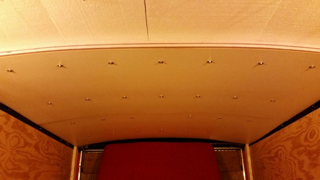

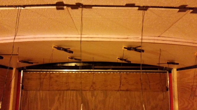

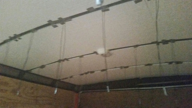

Postby Chilly Willy » Thu Oct 23, 2014 4:39 pm

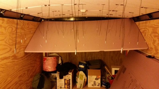

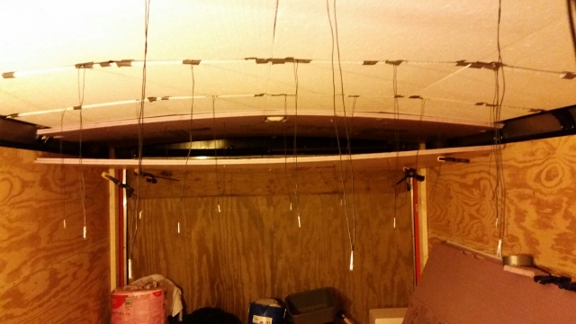

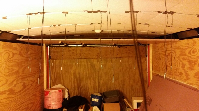

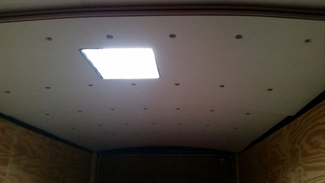

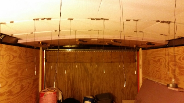

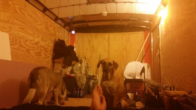

The thought occured to me that I could just bend some insulation sheets tight against the ceiling, and if I added 2 inches I could maintain enough height to stand up through the middle.
Hanging it there was an interesting brain drain. If I could have found some self tapping metal screws longer than 2 inches I likely would have just screwed it all up. I have zero experiece with suspended ceilings... which of course made that the obvious choice.. and obviously I'd need to invent my own hanging system rather than ask for help.
Tackled the easy part first. Screwed up some wires. Of course once you commit like this you then start to consider the challenges... like adding multiple curved surfaces, how the drill holes will all skew out of alignment...
My crew patiently waiting while I contemplate the next step.
Ok so could you put some shoes on and finish the ceiling before winter hits, please?

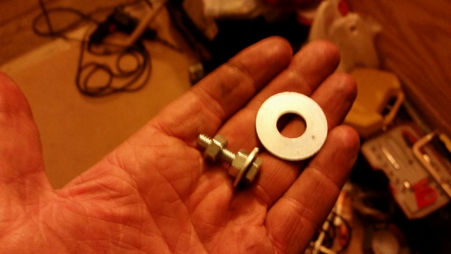

Postby Chilly Willy » Thu Oct 23, 2014 4:51 pm

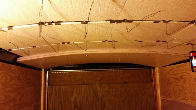

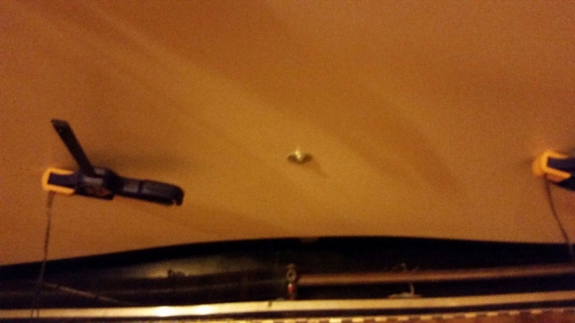

The hanging system I invented while pacing the aisles at Home Depot. 1 inch bolt with a small washer and two nuts, and a larger washer. Slide my roof insulation and finishing layer up onto the wires - wrap the wires between the nuts - tighten the nuts and trim excess wire - turn the bolt which will twist the wires and draw the whole business tight against my roof beams. Sounds like a good idea right? Not so much, but I'm too far along now to change.
Chilly Willy
Posts: 68
Joined: Mon Apr 14, 2014 5:30 pm
Location: Alberta, Canada
Re: 2008 8.5x18 Full timer project -> begin!
Postby Chilly Willy » Thu Oct 23, 2014 5:11 pm
And it worked. Only broke one, and no way to fix it. Likely just glue it on so it looks consistant. Once I add walls they'll shore up the perimeter, and maybe some fancy duct tape to keep the seems together for a finishing touch.
