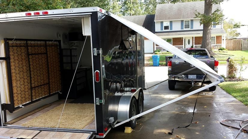

125552
12' x 10' Medium Duty Tarp attached to trailer with 4 hardware store hooks, 1/2" conduit for poles, ratchet straps to hold tight. Takes about 10-15 minutes to set up by myself. Probably $50 spent not counting straps that I have to have to tie the bike down anyway. Only drawbacks are the poles and straps in the camp area and there is about a one inch gap between the tarp and the trailer that drips a little when it rains. The door does rub on it, but it has rounded corners so it doesn't seem to be a problem.

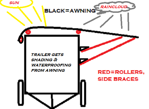

After looking at the prices of RV awnings on rollers, ARB and Rhino Rack awnings, I imagined making my own...much like ksbiker's set-up. But, instead of just attaching it to the side of my 4x8 (yes, nota cargo conversion), I want to anchor it on one side, and use PVC tubes to suspend it over my trailer, serving as rainproofing and heat insulation (asilver, heavy-duty tarp) for the trailer roof, and as an awning for use on the "front porch" of my campsite. I posted this http://www.tnttt.com/viewtopic.php?f=21&t=60607&hilit=+tarp Easily attached, easy to remove and store. Haven't built it yet; another project comes first!
dual-purpose rollout awning.png (37.13 KiB) Viewed 5236 times

working on it, Howdy;
Interesting thought about the trap over the top, but I'd have to figure a way to raise it above the vents
and some folks have an A/C up there to ponder about as well.....
