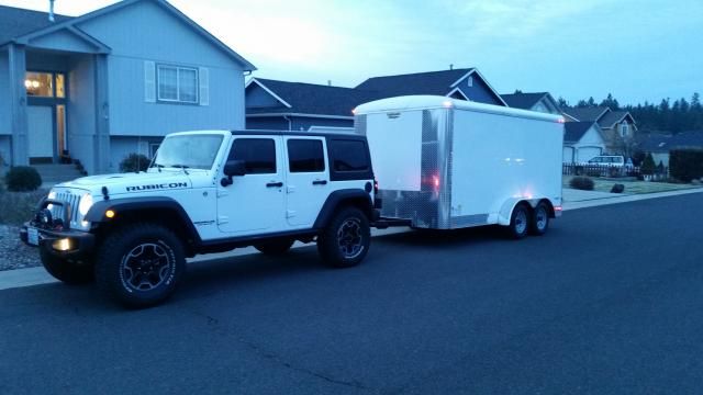

It's home...
...now the work begins. :applause:

Nice looking trailer. Good luck on your build, and take lots of pictures! :pictures: :D
